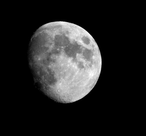

I shot the full moon as well.... (please excuse the soft focus, my manual focus was off)

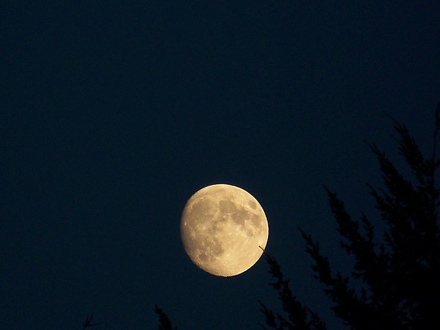

Here's a dusk shot that I took a couple of years ago:

The second moon picture you took is amazing! You mention that you did not use a dslr. So that was just zoomed in on?
@TCD photography
Thank you! My lens's longest focal length is 100mm when fully extended. With the purpose of cropping in mind, I shot - all hand held - with a larger file size than I normally do, so all I did was crop the shot and do some sharpening in post.
