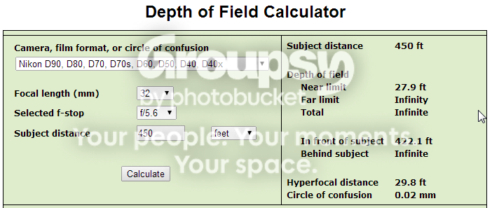

Note too I didn't have to use a tiny lens aperture like f/16 to get a deep DoF.
That's because the point of focus (PoF) was far from the camera, I'd guess about 600 feet.
Using 32 mm @ f/5.6 and being conservative using 450 feet as the PoF distance:
• at 450 feet to the PoF, the near DoF limit is 28 feet from the camera
• the far limit was infinity
Actually, it's because you used a wide lens and not the POF.
Just swagging the DOF; an APS camera with a 32mm at f/16 the hyperfocal distance is ~10ft (30% of 30mm). At 2x the aperture (f/8) it's ~20ft (double) and at f/5.6 it's ~30ft. REGARDLESS of where you focus the near limit for the DOF will never be greater (further) than the hyperfocal distance as long as you are focused beyond it. If you focus short of the hyperfocal distance you will get a small increase in the DOF near the camera but loose a lot at the far end. Maximum DOF occurs when focused at the hyperfocal distance.
That said, if the stuff close to the camera is not important I would recommend focusing on the furthest object you want "sharp" because DOF does not mean "sharp," it means "acceptably sharp."
