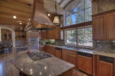

Final image from Photomatix

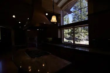

raw images

"Cartoonish" colors is Photomatix's middle name. Your final result is way too flat and somewhat too dark. So it needs to be lightened and have the contrast raised. Since you posted all of your original exposures I ran a version through for you to see that's lighter and has more normal contrast.

Yours looks to yellow, OP has better color than your edit.
When I want to get a more realistic HDR I turn down the strength between 60-70, bring down the color saturation to 40-50 and crank up micro-smoothing to about half way (using photomatix). This usually gives a nice realistic HDR. I always use photoshop to layer mask details I want in or out. I also will color correct when needed.
Here is your files using my methods.
interior by VIPGraphX, on Flickr

The OP's final Photomatix image is 'muddy', and the colors are dulled quite a bit. The final image is quite soft, as if the multiple exposures were not aligned very well.
To me the OP's final Photomatixwhite balance is good.
I would say 8 exposures was massive overkill and 3 would have been sufficient. One correct for outside the window, one for inside except the shadows, and 1 for the inside shadows.
I would have used #1, #2 for inside, and #7 for the outside exposure.
The muddiness, or haze often results from having to little mid-tone contrast.
I have taken the OP's final Photomatix image into Camera Raw, boosted the mid-tone contrast, capture sharpened/reduced noise (both globally), and added a touch of Vibrance.
