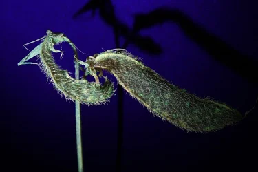

Hi Smoke I have a few examples with the file info for you and the how I did this its going to be a bit long winded.
For all the following images I used 5GBP uv torches from amazom mounted using plasticine
On all cases the camera was tethered via eos software using my 15inch laptop screen to view and control everything except the focus points
Canon 600d 28/105 @38 mm F18 Iso 100 S/speed 20 seconds
extension tubes used various have no record now

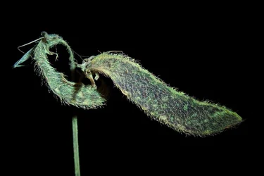

Canon 600d 35/105@48mm
s speed 6 sec
f10
iso 200

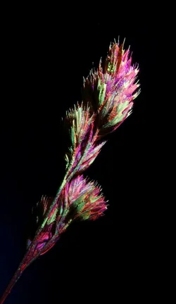

canon 70d
28/105 @43mm
S/S 1.6 sec
F25
iso 200

all three extension tubes used
this is pusing my camera to its limits
Note all plants were treated with uv reactive paint called Wildfire lit by as said two cheap pet urine finderuv torches in 405nm range using tethered via lap top using screen to view and control all except focus points
A uv filter was used on each lens to cut out haze and I wore sunblock on hands and used protective classes to protect eyes

the hardest task was finding a background that did not react to the uv light.
what are you going to photo as there is ring lights, rabbet ears, off camera flash or even cheap torches lol
for me the built in flash was no good as the lens ex tube combo blocked the light.
DOF is very small even at large f numbers

and sometimes I have to have another go. I got the angle of light to camera wrong 45to 60is about right but sometime you have to look and see this image was almost 180 deg
Cast a shadow and lit the background although the detail is good the pic is not what I wanted
