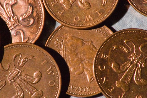

I was pretty sure there was a fair bit of zoom left, I'd zoomed out a bit with that shot in order to capture it as they were moving around a lot. So I had to preset focus, aperture ( wide as I could get it at ISO 200/1/1000'th) and wait for a butterfly to settle in the shot.
Anyway I did a test and while I accept that it can't go REALLY macro it's actually not bad.
Is a test I did ( it's also a test using an offcam flash ) and is about 2cm by 3cm in size.
ISO200, 0.3s, F32 - total darkness apart from the flash which was manually triggered.
