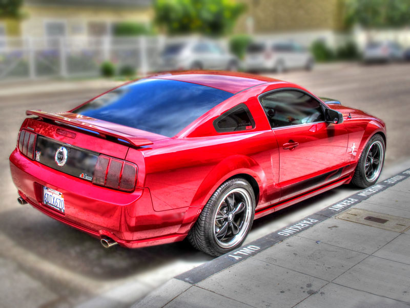

Tonemapped Nonsense...
Put it back in the oven for a little bit:
If you're going to blur stuff in software, at least pay enough attention to simulate a proper DOF. The car is sharp, but the road under it isn't. That's weird, and makes it seem very amateurish. I like the processing on the car, though.
Well, when it comes to stuff like this, I'm definitely an amateur. I've been messing around with this stuff for only a few weeks...
Make a layer mask, and mask back in the sharp pavement. As it is, it looks horrible. Parts of the car is even blurred. You need to zoom in, and work on 5-10 pixel level, to assure that you're only blurring what you want, and not accidentally the roof line on the car, etc etc.
Working with layers is pretty much image modification in a nutshell (in my opinion). Read and watch tutorials, and you'll see how it works. :)
Thanks.
I've not done much (aka "anything at all") with things like masks in Photoshop (I have Elements 10). I've found a couple of video tutorials so, when I get some time, I'll check them out.
As for masking back in the "sharp pavemtn", would you do all of the pavement?

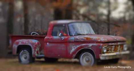

This is one that I did that I think also looks like a matchbox car.
The same blurring problem applies to that picture. The processing is awful!
Way overcooked. Without the added blur, it might have been a decent photo. I like a little extra cooking on the HDRs, but this is a bit much

laleemcc said:
<img src="http://www.thephotoforum.com/forum/attachment.php?attachmentid=11943"/>
It was looking good right up until you did that awful blur job. If you're going to add blur in post, you need to spend the 7-10 minutes to make it look right. Otherwise, you come off as a sloppy amateur.
Other than the blur, I like the truck shot. Nice work.
