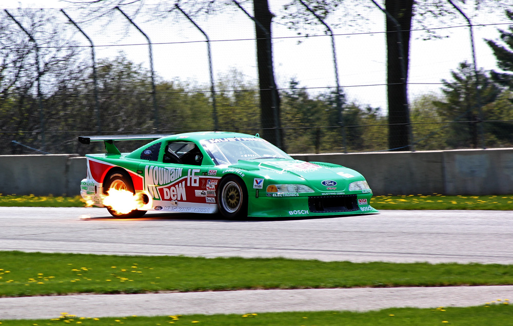

On a nice day, ISO 200 at most, shutter 400, and use the aperture to adjust the lighting. A silver plane body is a different exposure than a black plane or a dark blue. You'll need to adjust for that on the fly. :encouragement:
You don't care about the background or big deep depth of field, just the plane.
Panning is your best friend and if you shoot 20 "bad" photos to get one outstanding one, it's just electrons and there's a delete key.
That one is hand held but a monopod is easy to carry and takes a bunch of possible shake, jutter or wobble out of the equation.
Example is 1/400 - F/6 ISO 200 because I wanted to get the flames.
HAVE FUN!
ps neither of these is using a monopod, but still, it's a stability aid, and I shoot JPG not RAW, so pretty much shoot in camera.
