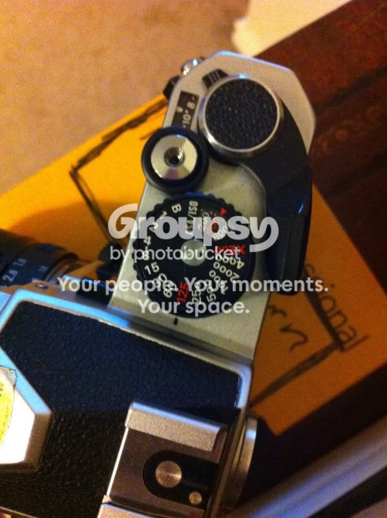

the top of my camera. Looks like its the FM2 not the n
YES, you have the first iteration of the FM-2 model, with the separate X200 speed in red...you can shoot flash at the X200 setting. Back in the early 1980's this was pretty hot stuff: 1/4000 second shutter, then the fastest speed in any factory camera, and that blazing 1/200 X speed, in an era when many 35mm SLR cameras had 1/60 top speed for flash.
