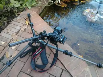

I don't have this exact combo, but I can tell you that I've used a Yongnuo 622C and 603C in tandem to do something like this. I mount the 622 first, since the 603 doesn't seem to want to pass ETTL signals through it, but the 603 works fine on top of the 622 -- either as a shutter trigger or a flash trigger or both.
