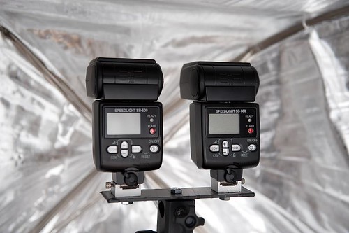

You can also pair them up and end up having more power than a single SB-800 or SB900 too. ;)
Now, 2 is about as far as I would go in doubling up. Beyond that point, it is actually cheaper to get 1 huge monolight for less and get far more power than, say, 4 SB-600s.
That's very cool but not quite CLS compatible... lol Your SB-900 as a controller with 2 SB-600s will be such a pleasure to use as it a LOT more powerful and is adjustable in 2 ways using CLS... remote manual (set all power presets via the commander mode in the menu in your camera or on the SB-900) or set all 3 to TTL and let the camera/flashes set the power to each light to give you a perfect exposure without doing a single darn thing. :)
