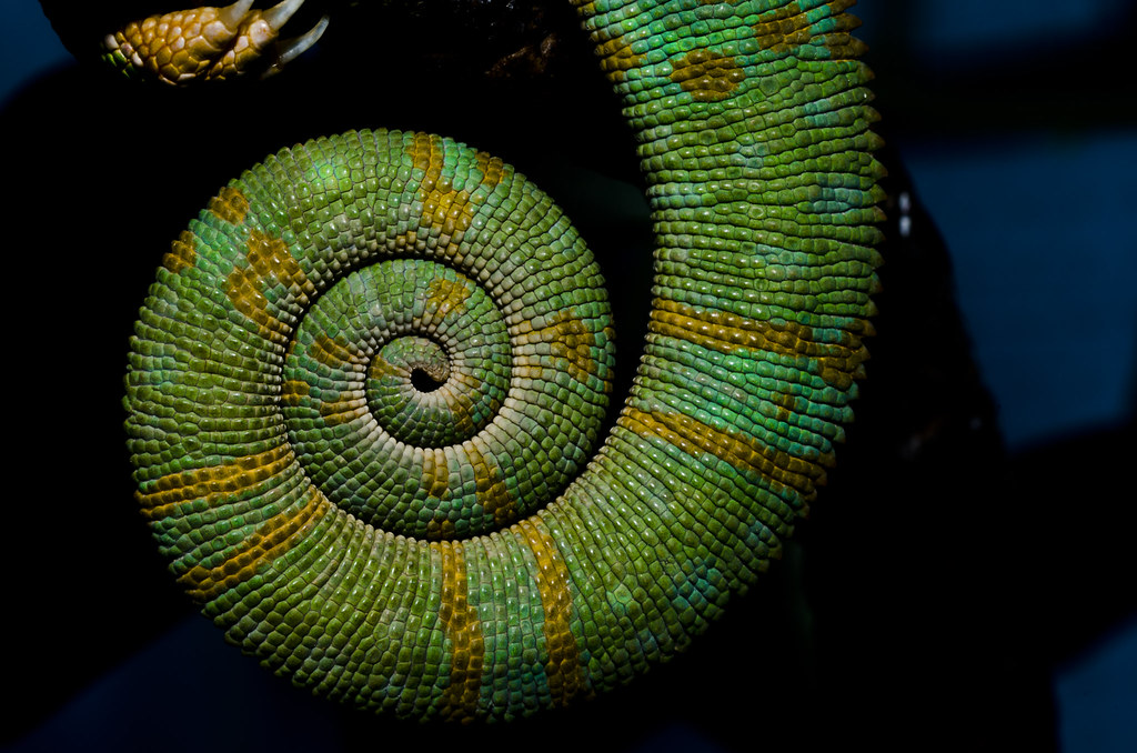

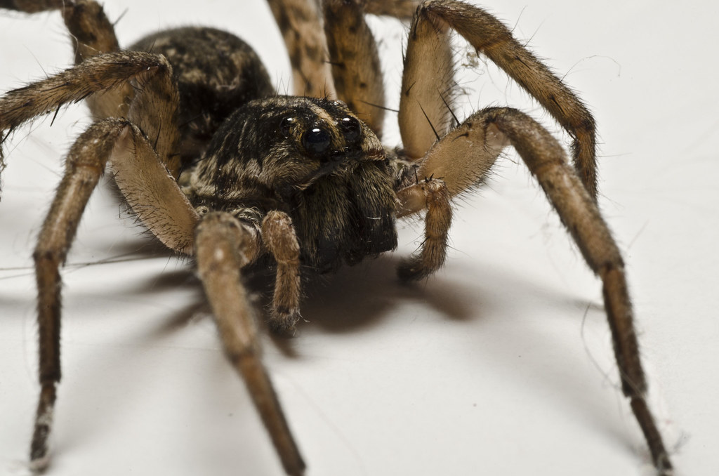

At the moment I am using my D5100 and Tamron 90mm (1:1) for my macro work. And I was wondering if I should look into extension tubes, teleconverters, reversal rings, or anything else for this type of work. I just want to be a little bit closer. ;)
Here is some of my Macro Work:
_DSC0603- by SarahSurfr, on Flickr
_DSC0574- by SarahSurfr, on Flickr
_DSC0529- by SarahSurfr, on Flickr
_DSC0418 by SarahSurfr, on Flickr
