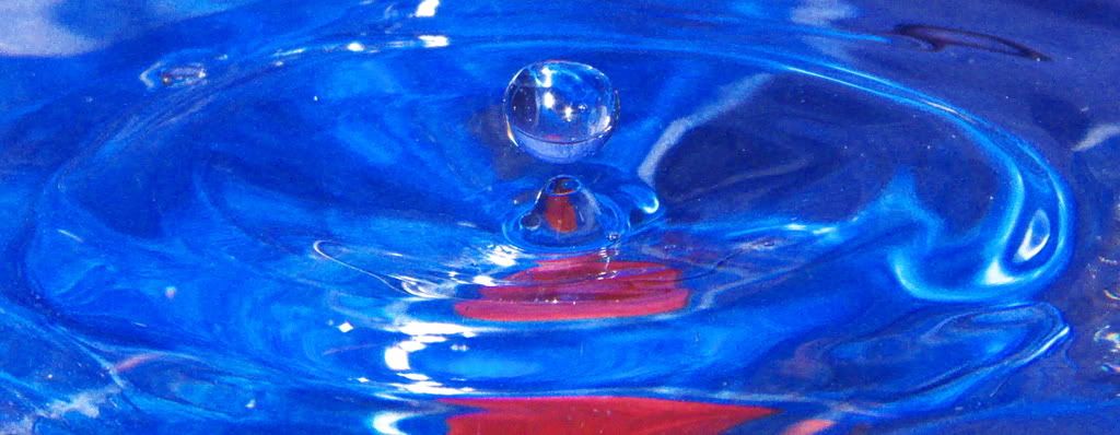

I don't have any experience with this type of shot (once I get a flash I will try, though!) so I can't give any tips, only observations. I like the shapes and "designs" however, they don't seem as crisp as the shots above. Perhaps an ISO setting? Heck, I have to admit I'd be happy if my first attempts were 1/2 this good....
Yea i noticed that too, I think its because I didn't have a tripod with me, I was balencing the cam on books and couldn't get as close to the water as id like. So these images are the result of a massive crop job.
