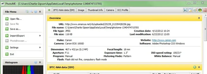

Did anyone notice that the exposure time on that sky shot was 1.3 seconds... long enough for some sensors to heat up and produce noise. Not familiar with her bodies... but I know that is an older small sensor body....
18mm
F11
ISO 100
^^ especially at 104° F
Why would someone need a 1.3sec exposure at f/11 on what appears to be mid-afternoon?
Totally!
Here is the exif.. for anyone that is Exif challenged! ;)
This must have been shot in the evening. 1.3 sec would be blown at the time of day that I initially thought.
But yeah. High ambient temperature, entry-level, older DSLR, long exposure: some noise, especially in the sky, is prob to be expected, even at ISO 100.
Definitely! I was surprised no one caught that! Gotta remember to check the Exif when you can.. it don't lie! lol!
