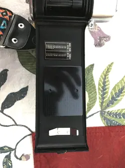

ok so I opened the Yashica this morning and well there are no seals on the back or door

A previous owner may have cleaned out what was left of them without knowing their purpose so did not replace them.
Replacement seal kits are available from on-line vendors.
Check the condition of the seals at the hinge and clasp ends of the film back. Some sellers spiff up old cameras I've rejected by stripping out all that gooey decayed foam and never replacing it. If it's MIA, then try some thin adhesive-backed sheet foam stocked by most craft stores that's easily cut to fit. That's usually the culprit behind leaks positioned like those in the negs you posted.
