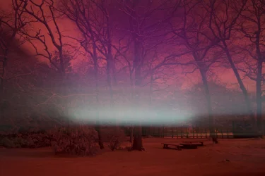

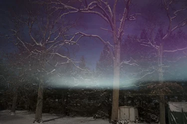

Shooting with a Nikon D600 28-70mm f2.8
The lens without any filters is flawless from what I've seen. However whenever a filter is added (77mm) an obnoxious image destroying glare of some sort appears. It doesn't appear in every photo though even with the exact same settings just seconds later. I've tried hoods, shading the entire camera, fluctuating iso, aperture, exposure times of course. Nothing I can find is consistent with this glare. The red image was taken with a Hoya 72r Infrared filter, iso50 f10 20 seconds. The photo on the right was taken with a b&w filter 3.0 (both filters 10 stops down), iso50, f22 13 seconds. I must say it's very irritating. :grumpy: Any ideas on how to fix this?
Put a cover over your viewfinder (it should have come with one). It's light leaking into the camera body and reflecting on to the sensor.
If you don't have one, either cover it with a glove, hat, lens cap, whatever. I bought 5 knock-offs from ebay for $3 shipped.
