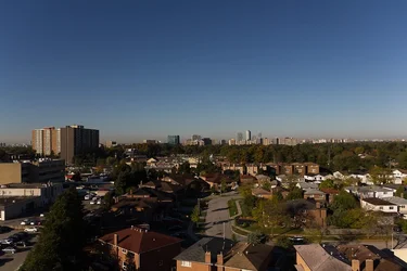

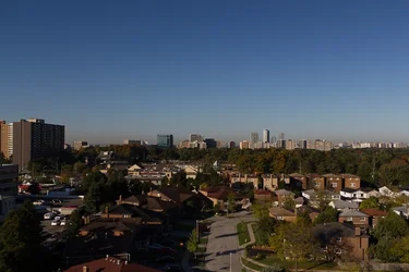

Not great photos, but they show what you lose if you have 24 mm instead of 18 at the short end. I picked the top right corner of a building in the distance so the centre of each photo is the same.
18 mm 24 mm
Wow, thanks for the quick comparison shots CC. That's pretty significant (and would likely irritate me). I'm probably going to rent a couple of lenses from the local store before I decide which to buy.

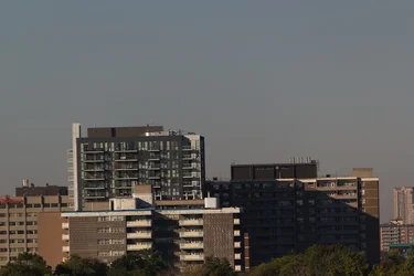

For giggles, here is the same centre, from the other end of the 18-250 lens
and a 100% crop from the middle
... and the lower left corner
I should mention, the tree is a city block closer than the light brown wall, and a couple of blocks closer than the wall with windows.
