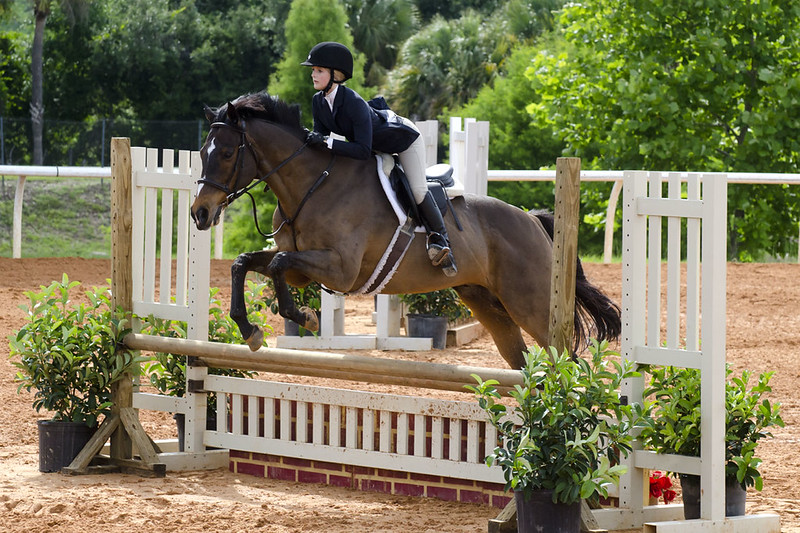

I went to a horse-jumping show some years ago and shot these. The first was mostly sunny, 1/1600 at ISO 400, aperture ended up at f:7.1. The second was during rain, 1/100 at ISO 800 (as high as I was willing to go on my camera at the time, a Nikon D7000,) and the aperture came to f:4.8. In both cases I was about 60 feet away. It's pretty obvious that the rainy picture is not as sharp due to the much slower shutter speed.
