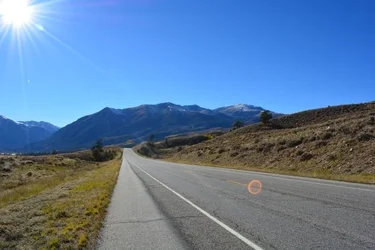

I'm not sure what the red blob is on the pic. It happens when I click camera facing sun. Its Nikon D5200.
i put on a uv filter then it had light green gradient slab....any help ?

it's there for the same reason the sun is appearing like a gigantic ninja throwing star...
Red blob: lens issue, very common when shooting toward a high, strong sun. WHewn the UV filter is added, the green flare is caused by the FLAT surfaces of the UV filter...filters very often flare when shot toward the sun.
ah I see.. I haven't seen this with point and shoot cameras.. well did get around by putting shade by hand.
well, i was going to say gigantic sun flare, but then that wouldn't have been a good metaphor...
UV filters generally cause more problems than they solve.
Only put a UV filter on your lens for 'protection' when there is some imminent threat the lens needs to be protected from.
