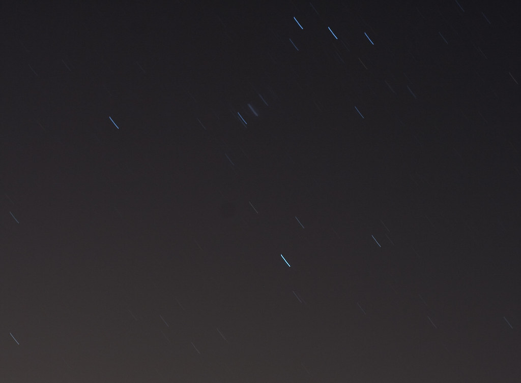

So I just recently noticed a spot showing up in my photographs. Below are two examples, one at night and one in the daytime. I'm not sure if it is my lens, camera or what but it is driving me nuts. Anyone have a suggestion?
Thanks
#1
(It's almost smack in the middle)

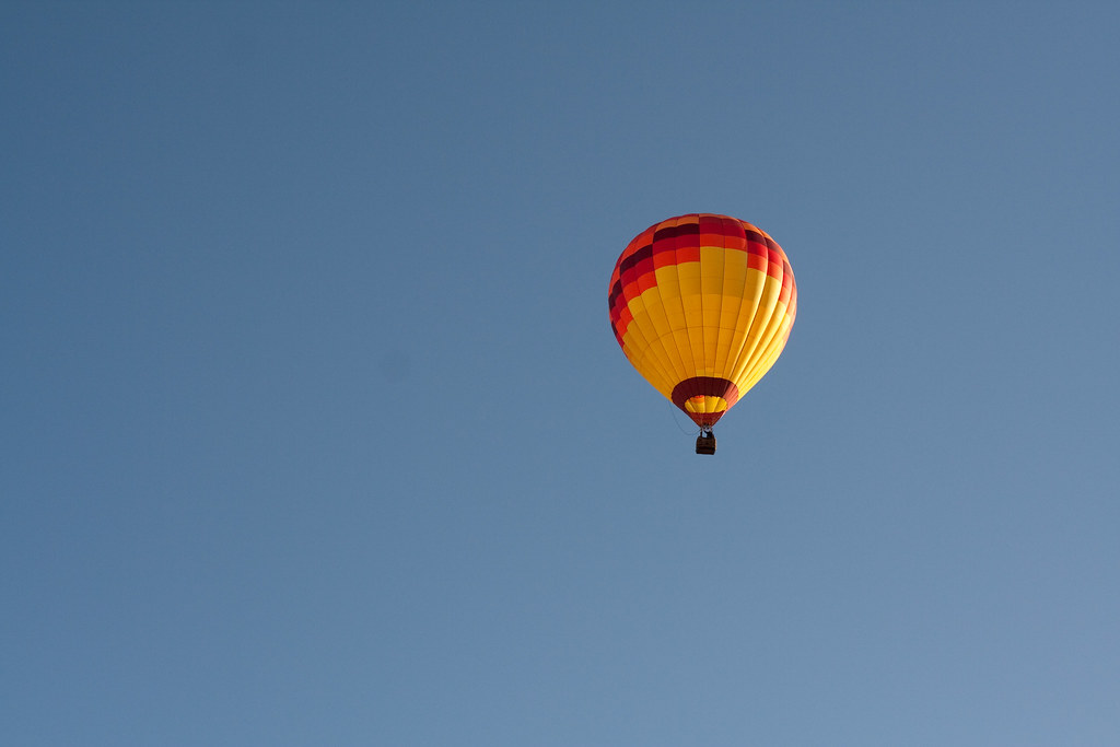

#2
(just left of the balloon)
Let me know if you can't easily see it an I will draw around it in PS.
Thanks everyone, I did what the article suggested, shot it at f/22 and saw two dust specs. I then cleaned it and both dust specs are gone, awesome, thanks!
