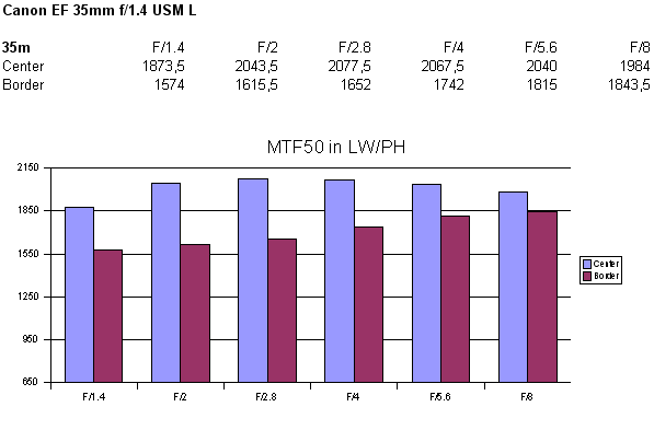

For example, below is the sharpness chart for a lens I have, a 35 mm f/1.4L Canon. The higher number, the sharper the image. For this lens, if your subject is in the center, then using the lens at f/2 is about as sharp as you can get, though f/2.8 gets you about 1-2% finer resolution. Objects around the border require going to f/8 to get comparable resolution.

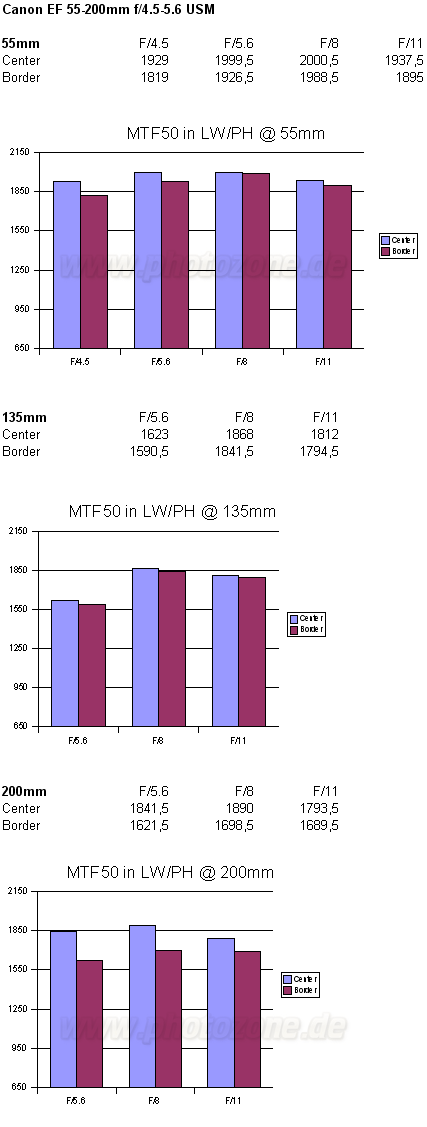

For this Canon telephoto zoom lens, 55-200mm f/4.5-5.6 USM II, the sharpest is around f/5.6 at 55mm, but it shifts to closer to f/8 at 200mm.

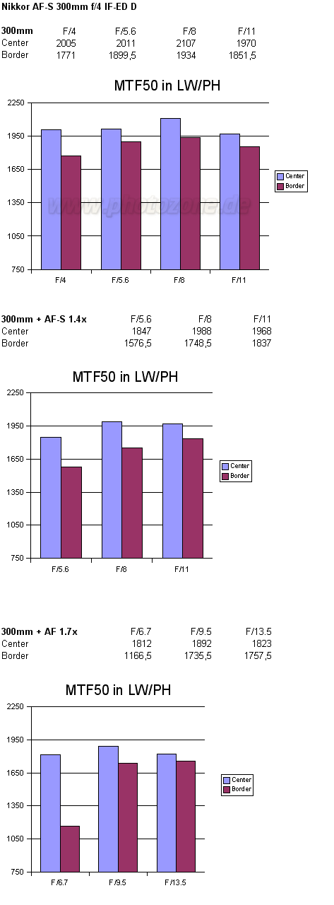

Here's an example of a Nikkor 300mm f/4D lens. In this case, the sharpest in both the center and edge is at f/8. However, attaching an extender both lowers the overall sharpness and moves it to around f/9.5.
