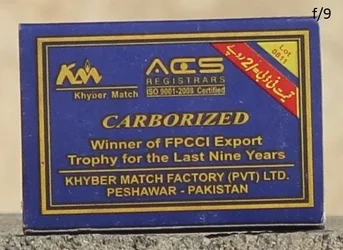

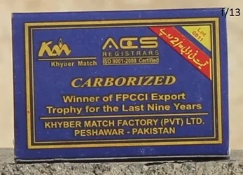

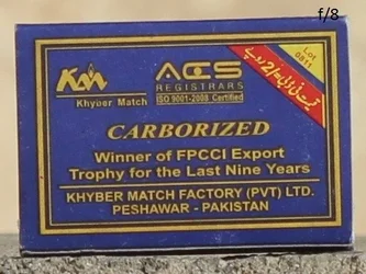

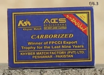

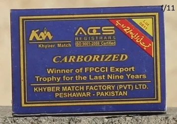

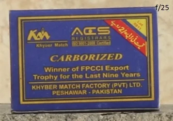

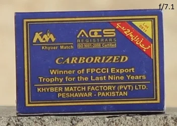

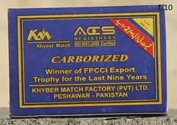

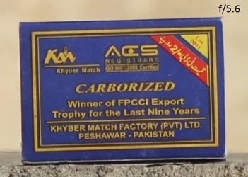

In order to make the point more clear I have taken few shots with Kit lens Canon 18-55 mm IS-II. The subject ( a match box) is placed at a distance of about 7 feet on a cement block and there is a wall in the background at a distance of about 6 feet from the subject. Shots have been taken at various aperture settings with fixed ISO of 100 and focal length of 55 mm. I have noticed that sweet spot of lens is at following apertures f/8 to f/13. (all pics have been cropped).
The basic idea is correct (for 55mm only), however I hope also you manually focused every image. If not, a slight front or backfocus will have effect (blur) only on larger apertures, giving the false impression of better sharpness for smaller apertures (greater DoF).
