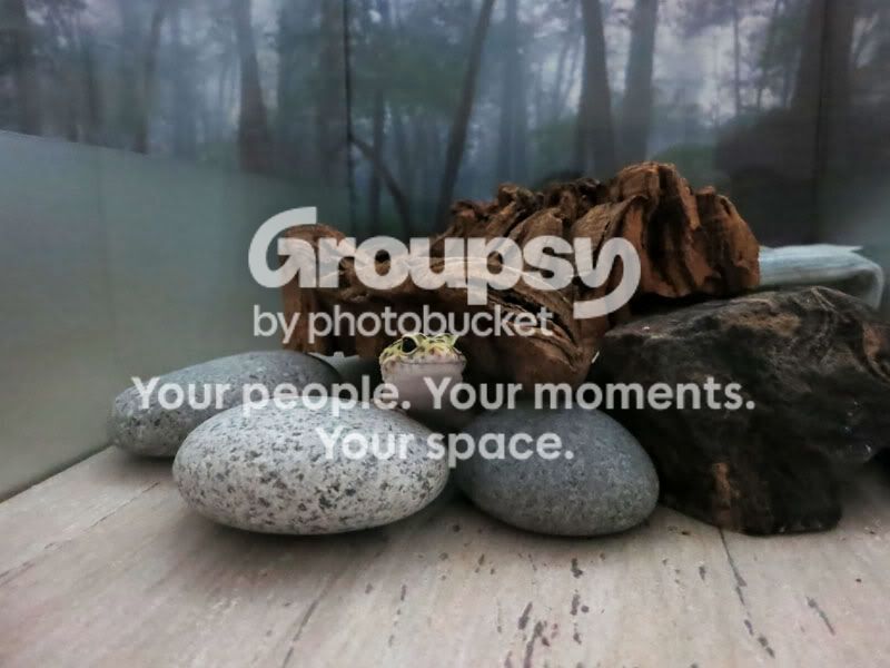

Hi, I'm looking to buy a camera to take pictures of mt pet geckos. They are nocturnal, and will only come out of their hiding place at night when the room is very dimly lit (about 30 lux). I used to use a Canon Powershot G9, I was happy with it overall, except anything over ISO 400 becomes very grainy. Then last December, I "upgraded" to a S100 for the larger aperture (f/2.0 vs G9's f/2.8) and the digic5 image processor. Here's a picture taken by the S100: ISO 1600, f/2.0, shutter 1/5s:
For my purpose, I'm happy with the quality of the image above. Please note that the picture was taken at night with minimal lighting, yet it appeared as if it was taken during daytime. However, the downside with this camera is that I cannot zoom with this lighting condition. As soon as I zoom in, the aperture drops drammatically, the image becomes too dark and is not possible to focus. The LCD display also lags, making it very difficult to take a quick shot especially when the gecko is moving. I didn't seem to have this problem with the G9, even at ISO 400, I was able to zoom in to make large head shots. So, I think I might sell the S100 and upgrade to a more suitable camera again. Any suggestion on which camera will suit my purpose? The geckos are in glass tanks that are 1.5ft wide and 2ft deep, the room is very dim, I won't use flash nor the auto focus assist red beam. I would like to be able to zoom in and produce pictures that are acceptably bright. Hopefully, the LCD display won't lag (the G9 is very smooth). I'm a newbie in terms of photography, I tried to do some researching these 2 days but it's confusing sometimes. If I'm not mistaken, I think I need one that has a large sensor, large aperture camera? The new Canon Powershot G1X has a much larger sensor than the S100 but the lens is only f/2.8 max. Do you think it will out perform the S100? Or, do you think I would be better off with a DSLR? With a large aperture macro lens? Thanks.

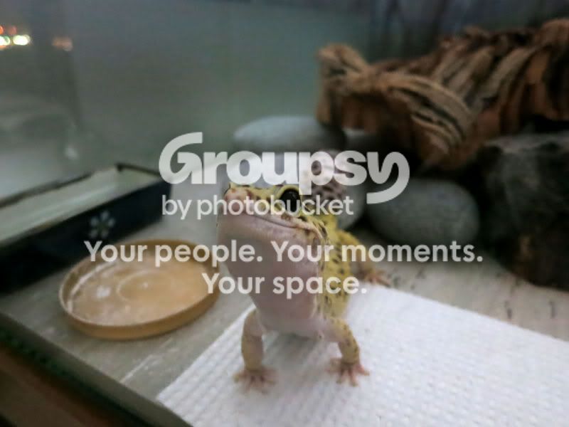

Here is another picture of the same gecko, he is moving towards me to check out the camera. I need the camera to be able to focus quickly and snap shots like this:
I guess my question is, if I get a fixed lens e.g. 50mm f/1.8, will I be able to focus on the subject at any point inside the glass tank without me moving the camera back and forth? Or do I need a zoom lens for that?
