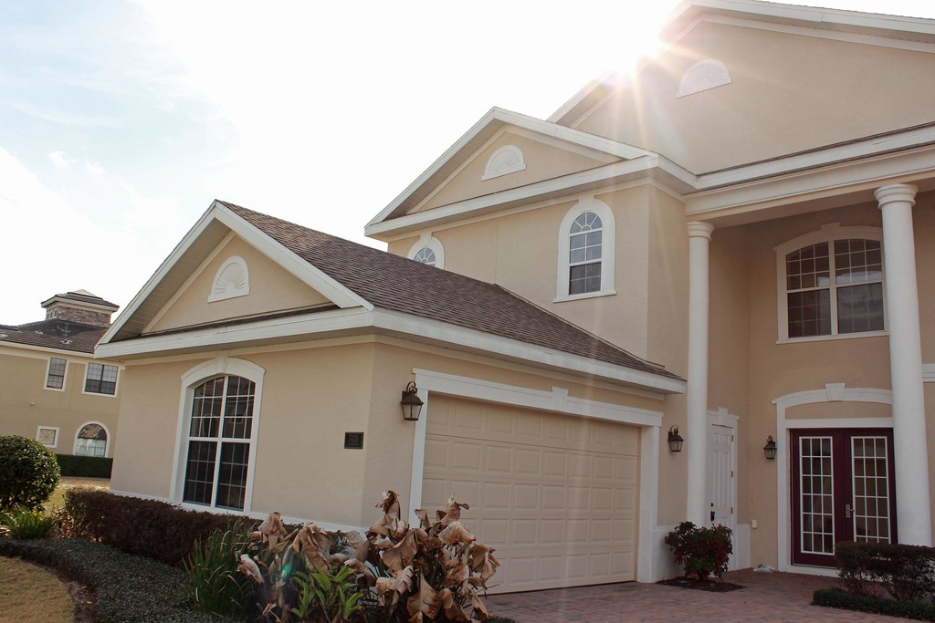

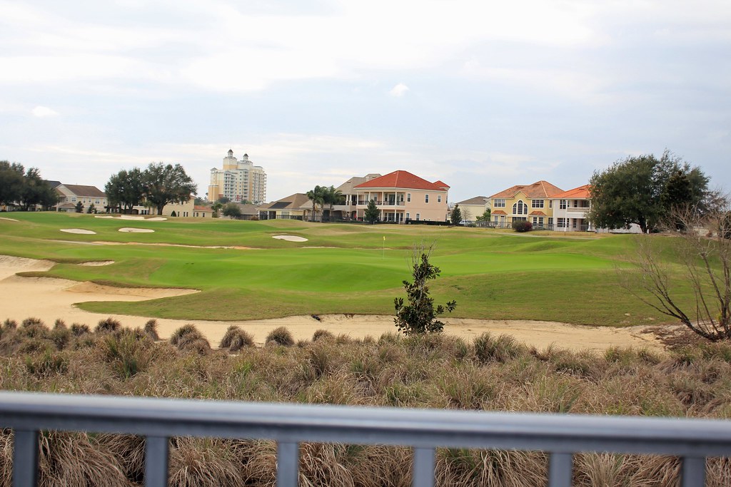

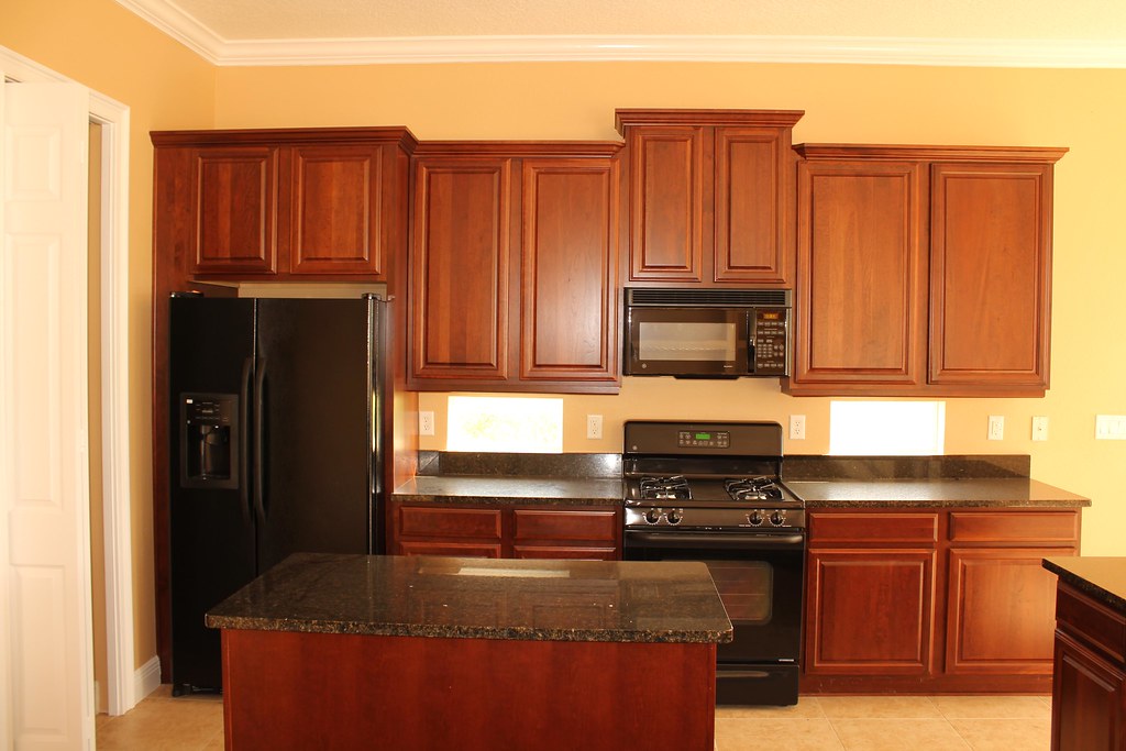

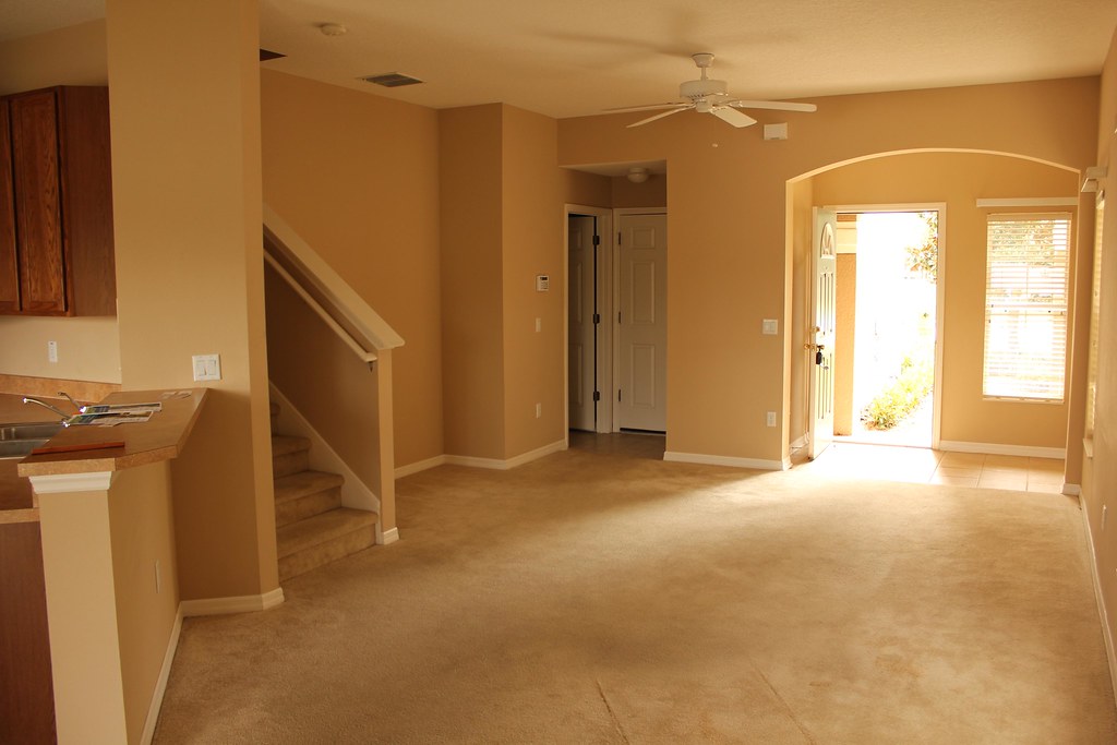

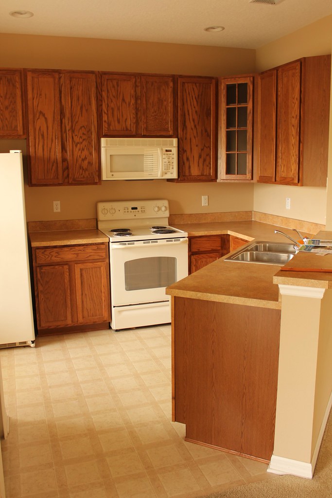

Just wanted to Thank you guys for the advice. Used a high aperture which is a smaller F Number, a low ISO and fired up shots with the AV mode.
much better than the previous pictures...:)
Anyway, why this guy who invented aperture couldnt make a high aperture with a higher number.
