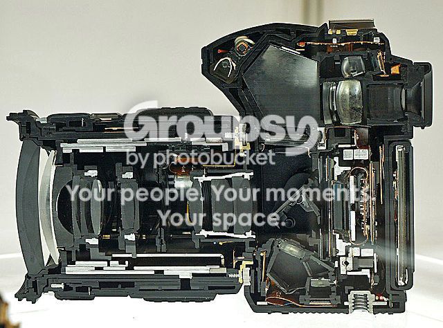

In fact, at the front of a camera lens is usually several quite thick glass elements in a group that support each other. Look at the cutaway photo below.

Front Element Scratches
License: CC BY-SA 3.0 Author: Hanabi123 File:E-30-Cutmodel.jpg - Wikimedia Commons
