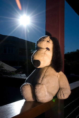

White balance set to Tungsten, Flash shot through a CTO Gel. Creates an interesting effect balancing the subject's colour against the background daylight.

Thanks for the great responses everyone, very interesting shots Garbz :D.
Yeah, no one messes with da Snoopstah. :lmao:
