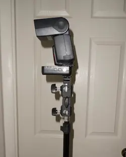

so, after my glowing review of the yongnuo 568EX, I decided to order some triggers.
up until now, we have been using sb600's and sb700's with Nikon's CLS system and have had no problems.
The decision to go with triggers was really based on the decision to get some third party flashes, even through the YN568EX WILL work with Nikons CLS if you have a commander flash on the camera. the issue would be for the times where we have OCF, but not a flash on the camera. solution = triggers.

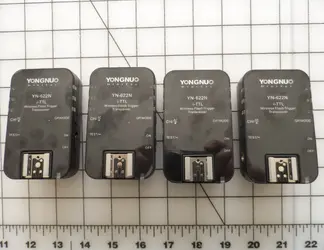

I ordered two pairs of triggers, at $80 a pair. very inexpensive compared to pocket wizards. I tested these with the yonguo 568EX, SB600, and SB700.
results were fantastic! very little setup to these things. one button sets channel, one button sets group, one switch turns it on and off.
they have a built in AF light that works great, and the TTL functions worked flawlessly on ALL my flashes, Yongnuo and Nikon alike.
focal length and aperture changes showed on flashes in real time, and i saw no misfires or delays. The YN-622N has 7 channels and 3 groups and a range of 100m. (i wont list ALL the functions here, you can google them easy enough)
overall: i am extremely pleased with these triggers. I would highly recommend them. while I have no experience using pocket wizards, I would be hard pressed to believe they are worth so much more money for the same functions that these guys have. (note however, that the pocket wizard flexTT5 has 52 channels over 26 frequencies and has a range of 240m TTL, 365m manual, but at $200 EACH) the range on these is really good too, as im sure all radio triggers are. down the hall, around corners and outside across the street did nothing to deter these triggers from functioning perfectly!
the Yongnuo 568EX flash was a great replacement for my OEM sb700's at half the cost, and i cant imagine a better value for the money than these yongnuo's if you are looking to get your flash off camera and you arent using Nikons CLS. Yongnuo has really hit it out of the park with the 568EX and 622N triggers. I see us going to them for all of our future flash/trigger needs. Sorry Nikon....I was a loyal OEM guy for many years, but you will have to be a little more competitive with your pricing before i will go back given the quality and functionality i am seeing with Yongnuos products.

one feature of the yongnuos that I liked was that each "trigger" can act as either a transmitter OR receiver, and it automatically knows which its supposed to be doing.
the AF light on the triggers is pretty substantial, but i have read that it is tailored more to center point focus than anything else. (which is what i mostly shoot anyway)
I DO like the idea of a commander module with an LCD screen, but its most useful if you have flashes set up in different groups. plus, the fact that the yongnous are compatible with nikons SU-800 commander module OR a commander flash really negates that benefit for me.
the price of the yongnuos coupled with the features they offer made them too good NOT to get them over the others.
I certainly DONT need the 52 channels the PW's offer.
the yongnuos had the shortest range of the triggers I looked at (100m for TTL), but i seriously don't see myself needing more than 300+ feet, so it was really a non issue for me. As was the yongnuos only having 7 channels in 3 groups. (i don't foresee needing more than 7 flashes at once)
will the yongnuo triggers stand the test of time? no idea, I just got them. all i can say so far is that they work perfectly with all my flashes.
they support TTL and HSS, have a PC port, and are compatible with my nikon flashes TTL.
I think pocket wizards are great. and if you NEED 52 channels....they are your only choice.
for those of us that DONT need 52 channels....there seems to be little to no significant advantage to paying for the PW's except for the bragging rights.
