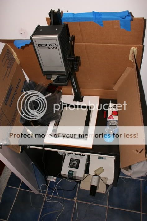

Small shooting space made this kind of difficult, but this is pretty much what it looks like.

I don't find it particularly "extreme"; it looks more like a clever use of existing space. Many people use the bathroom as a darkroom; running water is such a plus.

I want a dark room so bad. Maybe soon. I like the setup you have there, what do you have covering the window?

It's cardboard, which actually doesn't work too well. It's attached with velcro, which makes it easy to take on and off (something I wanted so the shower would be usable), but it does allow light leaks around the side. As it stands I can only use it at night. It would work a lot better to just put up some kind of black material and tape around the edges, but then, not so easy to take it off then back on.

Maybe just put the shower curtain up?
Look like a lot of school surplus stuff. My dark room looks a lot like that.

I use a peice of plywood with foam pipe lagging around the perimiter. When I want the darkroom I simply push it inti the window reveal & the foam seals the light out.
When my wife demands the use of the room for crafts with the kids I pull it out again.

To help you save some time in setup n breakdown... you really don't need the cardboard around the enlarger at all. Block up the window really well, put some weather stripping around the door n a door sweep n you are good to go.
BTW that easel... the white surface should be painted black or use a black paper under your print while exposing. I did some experiments some time ago trying to figure our where my fog was coming from n found it was the white easel reflectin back up through the paper (I have the same one you use) even though I use double weight fiber.
Try this one night... put a black sheet half way under your paper when making the exposure. You'll see half the print will be fogged.
