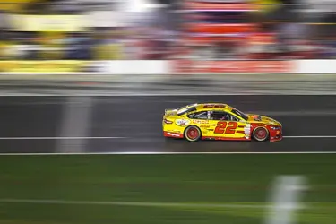

Theses are a few that I caught panning with my EF70-200mm f/2.8 L USM (non-IS) with my 2x II teleconverter. I added a little more motion blur to the background to make the car stand out a little more. I'm a big NASCAR fan, so I need a good NASCAR Lens.
