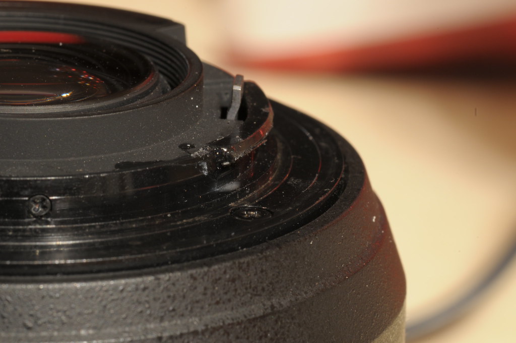

Long story short, I ended up landing on my camera. I knew when I looked down and saw the lens parallel to the camera I had screwed up. It's like breaking your leg and it's sticking out....you're like CRAP!
Only 2 mounts/guide "rails" broke off and I was actually able to Krazy Glue them back into place just kinda like as new. It actually is still working fine, only difference is a tighter fit. Who doesn't like a tighter fit anyways.
Is it difficult to repair this. Could the part be ordered and me replace it or better just to send it back to Nikon. I have had a problem with my aperture ring and figure this is just another reason to send it back into Nikon. I'm hoping the aperture would be replaced under warranty but I'm not sure about the broke mounts!
I will say it could have been worse. It could have been a metal mount it broke from the body....that would have really sucked.

Wonder if the "rail" has a Nikon part # that can be ordered? As often as they break it should be.

I'm sure that it does. I'd love to see a cutaway diagram of the 18-135 lens and see if I could do it.
Just to be sure, we are talking about the same "rail" right?
Like I said, Krazy Glue is amazing!

I guess it is the same rail. I can't see that much detail in your photo on my monitor, but I think I see enough. Hard to get a clear shot with so much black in the image.

The rails being spoken of are called mounting lugs. "Lug" is the correct term. I heard the use of the term "rail" a few posts ago,and was puzzled by it, then when the one owner said the lens he had had to be held onto the body, I figured he meant the mounting lugs.
The lucky thing is this: a new lens mount ring assembly, complete with all three mounting lugs, is a really easy,quick repair for a camera repairman. The entire mounting ring is held on by either three or five screws in most cases, and the ruined one can be unscrewed and removed and a new one popped on, often while you wait if the camera repair guy is not too busy and he has an appropriate mounting ring on hand. It's like a 10-15 minute job.
Still, props to you for your excellent use of the Krazy Glue.

I will have to see about someone in NC that could possibly do it.
The Krazy glue is working so far, and it's going to have to until I can get it fixed.
