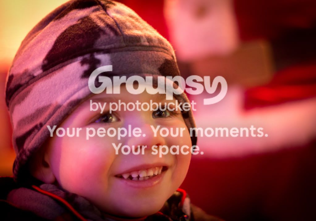

1. This one i got the eyes pretty much spot on. 50mm f/2.0 at 1/50 just not as angelic as number 2

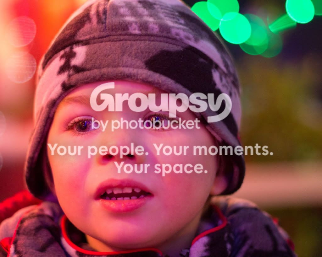

2. This one i love, except the obvious fact that his right eye is not in focus.. i just still am having a hard time grasping why this happens time and time again! is it because the face is turned a bit and the focus was on the left eye, and because at f/2.0 it to shallow a DoF?
The focus does indeed appear to be on the eyes, but.... they're both soft, due in part to a very shallow depth of field, and in part to (for #2) I suspect camera movement from the low (1/30 sec) shutter speed. Estimating the distance to the subject at 3'; your DoF is something in the order of 1/8". Yes, ONE EIGHTH OF AN INCH! Have a look at a DoF calculator such as this one to get a better idea of what apertures to use at what camera to subject distances.
f/2 does provide a VERY shallow depth of field. Shooting at a close distance also accentuates this. In addition, you're using a crop frame camera which narrows your field of view. Your photos are not as sharp as they could be because you were shooting at 1/50s. When taking photos with a low shutter speed, make sure that your shutter speed is at least 1/focal length (which yours was on shot #1). But ideally, you'd want it to be 1/60, or 1/80 to prevent camera shake since you are using a crop frame camera.
The reason that both eyes are more in focus in photo #1 is because they were on the same focal plane, whereas #2 had one eye on the focal plane, the other in front.
yea, i knew that them being soft was a probability hand-holding at 1/50 and 1/30 and going to be a problem shooting at those speeds. three feet sounds about right... maybe a bit closer than that actually. So looking at the dof calc it probably would have suited me better to taker a couple steps back and then crop down ?
Either that, or close down your aperture to f/3.2 - f/4 or so to get better DoF

Hey, yes, the reason is because you are working with such a shallow depth of field that with the eye being slightly farther away from the lens, it is slightly out of focus. My personal preference, if you are working with such a shallow DOF is to have the eye closer to you in focus as it leads you into the photo more.
Unless it's an artistic choice you are making, it's nice to have both eyes in focus. You could try closing down your aperture and increasing your ISO to keep the exposure the same, and see if that helps things.
