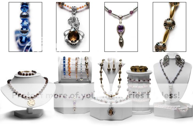

Below is an example of one of her pieces which also shows the level of detail I wish to meet or exceed in the shots.
What I am very new with is setting up a similar studio and camera setup to acheave such results.

Honestly, you can get that type of result fairly cheaply. Take a look at strobist.com. In fact, here's a link to some small photography shots he did with just a cardboard box and some speedlites.
Strobist: Food Photography Made Easy: The Lunch Box
You can spend a ton on lighting. For some people, it's necessary. For what you are looking to do, I personally think it's not something you need. You can get great results with some minimal investment.
While at strobist.com, check out his lighting 101 and lighting 102 modules. That will get you started.
For reference, I have a full set of GOOD lights. My speedotron setup is the same one I see in lots of studios. However, I rarely set it up anymore. I tend to travel lightly and use speedlites to get some good results. If I need my full setup, I have it. However, I highly doubt I would get that out to shoot small rings and other items of that size. You can buy a small photo tent (Or use an old box with some tracing paper) and use some speedlites to get the same results you posted above.

A macro lens probably wouldn't be the best for product shots of jewelery. You'll want a smaller aperture for a wider DOF. A shallow DOF might be pretty an all, but if you're trying to sell a product and only one small portion of it's in focus, then it's not going to be very appealing.
Also, the prime recommendation is good. Primes are usually sharper than zooms. You want to sharpest pictures possible, but along with that, the 5DII is 21MP, you can shoot and downsize for sharpness.
Ed: And I'm tempted to tell you to go with an Alien Bees lighting kit. A set of the B800's would probably be within your budget. Is it overkill for jewelery? Probably. Will in come in handy for portraiture or and future purchases? Definitely.

Congradulations on landing the job! Great budget to work with...I'm sure you'll have no problem acheiving those results with a 5k budget. The people who posted before are correct....you can achieve the results in the picture you posted for much less, even less than half of the allowed budget...but at least it's an excuse to get some great gear ;).
I'm a professional photographer and shoot alot of product right out of my home. To shoot product I have found my westcott spiderlite TD5/3 continous cold light lighting system really makes product photography a joy! using the soft boxes takes away the need for ackward light tents and all you need is a paper backdrop and BINGO! here is an example a basic set up
This is just one spiderlite TD3 off a boom arm...that will run you about $600 off of adorama or B&H new
These results are using a Nikkor 17-55 2.8, and a Tamron 90mm 2.8 macro for close ups
Hope you might of foun any of that usefull. Macros make great portrait lenses as well. I think of mine almost like a 90mm 2.8 prime.

Although, I would still recommend using some sort of a lighting tent, or just being careful with your reflections because you can see the softbox reflected in the jewels in the images which is the part of the purpose of the lighting tent.
