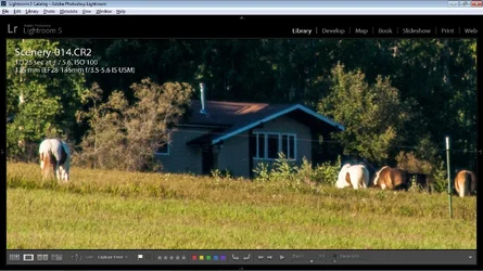

Greetings All,
A couple years ago I purchased a Canon 50D and although it gave great reviews and was affordable I can't say that I've ever been satisfied with it. Regardless of what I do I cannot get a tack sharp image with it even when using a tripod, turning IS on/off, autofocus on/off, flash, using a remote shutter, "spray and pray", etc, etc. The best images I can capture seem to have a real soft focus to them. When zooming in to the attached picture the pixelation is quite obvious. In addition, there seems to be a ghostly halo around white objects against a dark background. (yes, the lenses & filters are clean) The halo was first noticed and grossly compounded when using a 70-200 f2.8 and I initially blamed the lens however the attached photo was taken with a kit lens and the halo wasn't noticeable until I zoomed in. I understand that pixelation will occur when you zoom into a picture too far however at 1:1 (100%?), as this photo is, I feel there should be very little, if any, pixelation.
The 50D has a smaller sensor than other rival models but it seems to me that the images should be much clearer than I've been getting. The 70-200 is a fine lens but the problem seems to be worse with it. It now makes me feel that something is wrong with camera rather than the lenses. The attached image is typical clarity for my shots and if I remember correctly I had focused on the house in the background. It was a nice sunny evening and the distance was +/-200 yards but I can't be certain. No corrections have been made to the photo other than contrast, highlights and shadows.
I've been using film cameras since I was a kid and digital cameras, albeit smaller ones, for many years so I feel I'm competent enough to create clear images but I am frustrated as I had high expectations for this camera and my budget doesn't really allow the purchase of another. When I view photos from other websites, on here for example, the clarity is obvious but tack sharp does not seem to be capable with this camera.
I've done a fair amount of research on the web and the only thing I can find is that other 50D users are experiencing the same problem but no remedies seem to have been mentioned. I guess my question is, am I expecting too much from this camera? Will "calibration" from a competent camera shop help? Is the halo an effect that can be corrected?
The screenshot of the image does look soft. On that particular example, was it on a tripod or with stabilisation? The exposure shown is too slow to reliably expect sharp results hand-held.

So, the problem appears to be with your particular example of the camera. You seem to have tried most of the things that would improve this situation.

The horses in your example photo do look odd and if you've had this problem for a good while there is a chance that your camera is not in the best of health and it could have an out of calibration or very extreme set sensor calibration (manufactured goods are made within tolerances of calibration not to an exact figure).
Best you can do is to send your kit to Canon/service centre for calibration. They can then test your camera with your lenses and ensure that you're getting the best possible calibrated performance.
If the 50D has micro focus adjust remember that that only corrects AF performance and placing; it won't affect the maximum possible sharpness.
  • This shot was hand held with IS on, shot raw. Most likely a tripod with IS off would have given the same results.

Thanks for the suggestions, any thoughts on the halo effect?
When I suspected the big lens I rented another same 70-200 f/2.8 to compare with mine and had more or less the same results. Again, I'm really starting to suspect the camera is the problem and will try giving the sensor a good scrub (so to speak) and the newspaper trick. If that doesn't seem to improve things I'll send it in to Canon and in the meantime start negotiations with my better half for an upgrade. :mrgreen:
