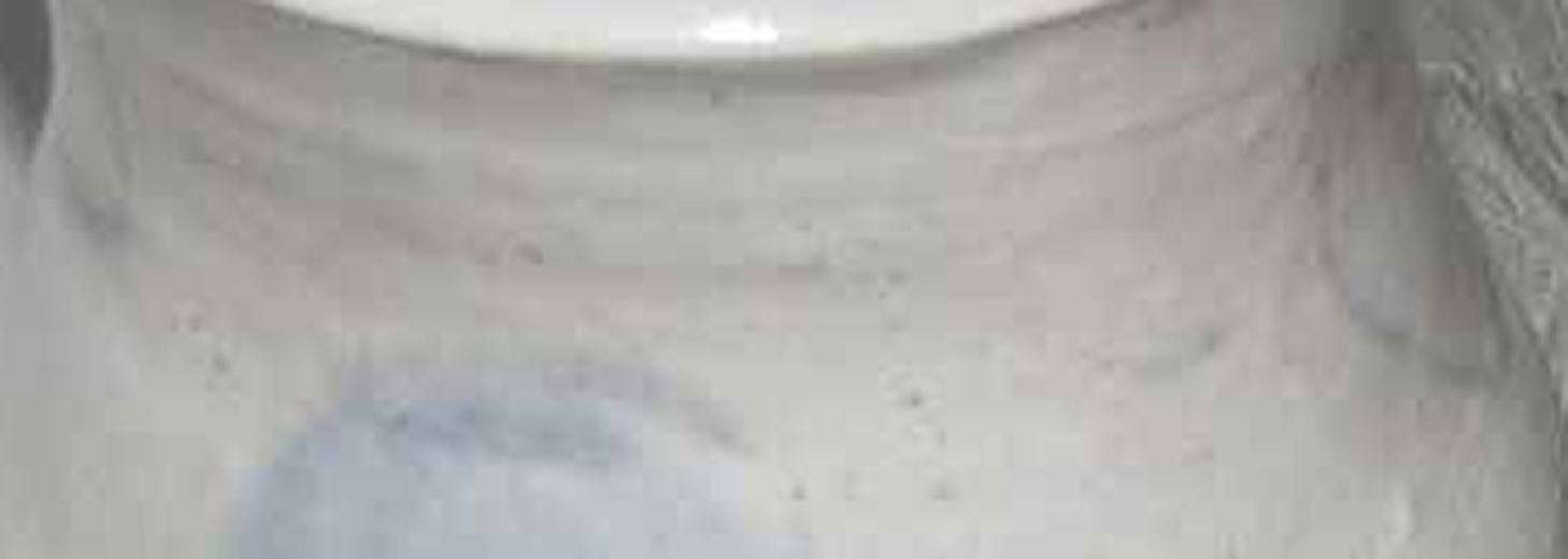

I looked at all 3 pictures in PS and the color balance appears normal.
If however I enlarge the picture, there seems to be a real pinkish color noise, see below, that certainly wouldn't be visible on a camera screen - and maybe not on uncalibrated monitors at normal resolution.
Perhaps there is some compounding effect caused by the interaction of this color 'noise' with the printer.
Perhaps the camera is set to over-enhance colors and the enhancement is most effective on red, putting it in where it isn't really.
I do think this problem starts with color noise of some sort in the image.

Plado,
IMO, there is something going on in the camera.
I see a pinkish blush in the neck of the pottery urn. (as does my wife, unprompted as to color)
Since we are seeing here a much smaller version of what is printing, my guess is that there is some sort of pink that is somehow contaminating the larger image and is also somehow being magnified in the final print.
(this is all a silly wild ass supposition, of course) see the 300% image of the jar of the pottery urn.
