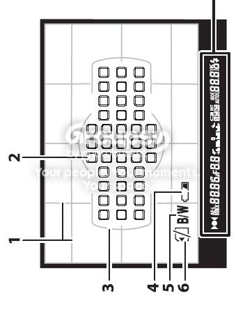

KmH this is the viewfinder grid, I guess I'm not understanding the photo that you posted.
You want the crown of their head at the very top of the box with the focal points, chin at the midpoint.
edit: actually, you want the chin very slightly below the midpoint, probably around the first row of focal points below the midpoint.
Oh my! Uh. Rotate the camera 90° CCW to the 'portrait' framing orientation. :thumbup: Notice how all of your focus point now kind of look like a person standing in the middle of the viewfinder?
Though you may only be doing head shots, heads/necks are still higher than they are wide, which is why you turn the camera so the frame is sideways with the long axis vertical.
The illustration I posted shows how 5x7 and 8x10 aspect ratios do not fill the viewfinder frame.
Note that the 5:7 aspect ratio fills the frame more than the 4:5 aspect ratio of an 8x10 (4x5) does.
The difference between the 2:3 native aspect ratio of your camera (8x12, 4x6), and the 5:7 you want to print is what will have to be cropped away from each photo so they can print at 5x7.
The 5:7 space does not have to be centered in the viewfinder. You can shoot so all the extra space is at the top or the bottom of the viewfinder.
You have time to practice how to frame for a 5x7 before you have to shoot the 600+ shots.
