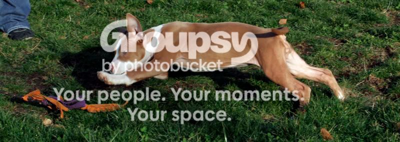

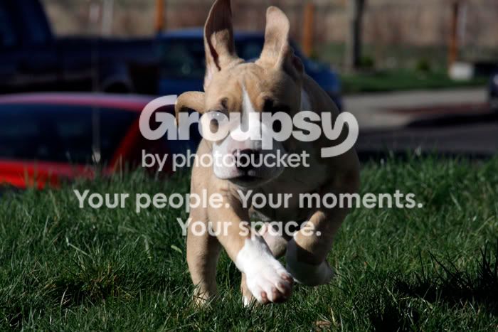

Wow.. beautiful shots gsgary! Those are precisly the type of clerity I want to achive. I have tried .. but will fail always. Hmm. here are a few of my photos.. maybe it will help to see what I may be doing wrong? I couldn't tell you the settings used however.

The biggest problem with your first shot is the harsh sunlight but it can be sorted just a very quick try
your settings were auto iso800, F16, 1/1600 which is way off the mark because you let your camera choose
I would be on manual iso100 F4 about 1/1000, but for you try aperture priority lens wide open center focus point only AI servo and adjust exposure compensation to get histogram correct shutter speed needs to be above 1/500 if you can't get that turn your iso to 200
