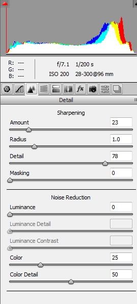

I have a Canon EOS 450 D with a 28-300mm Sigma lens. I was quite used to 35 mm film photography and has this camera now for more than a year. I have started with PS CS5.1 and is learning Camera Raw.
On a trip to Greece, I took this photo. I would like to describe my editing methods and if you can comment:
Taken as RAW- no editing:
Settings:
Settings changed in RAW:
More changes:
I thought everything was not sharp enough, as I want detail. I used Unsharp Mask:

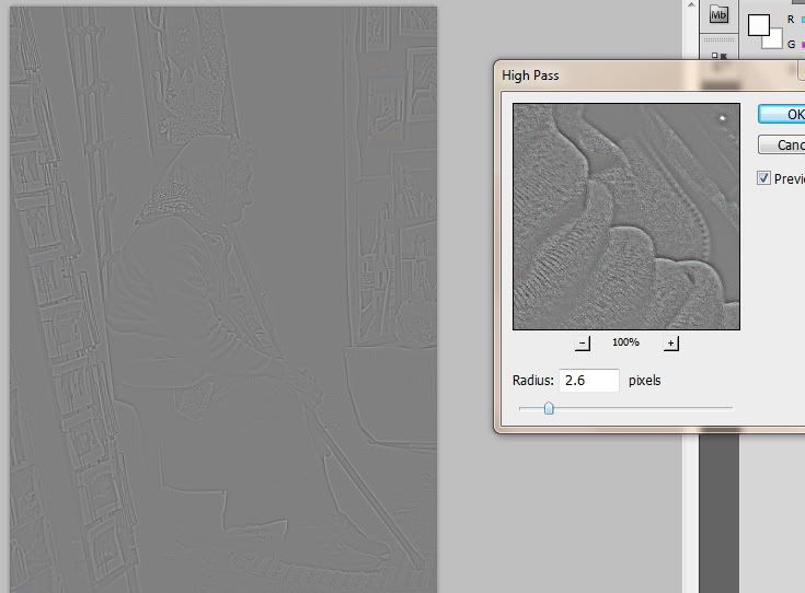

I duplicated the layer and used the High Pass filter.

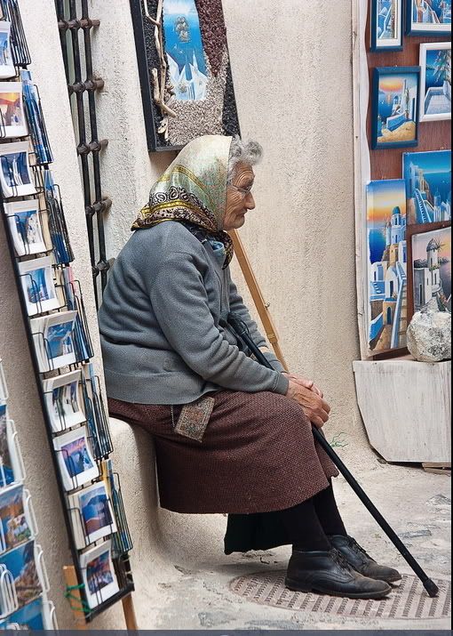

My final product:
(Her facial features now quite sharp.)
But on Picasa, it is too sharp?!
Any thoughts/critisisms/advice? I still struggle with sharp as well as the colours- I am red green coulour blind.
I would have lowered the opacity in the final highpass filter. A good way to do it is to lower it to 0, and then slide it up until you see your image pop.
Other than a tad bit oversharpened, I would say it was a pretty good edit.

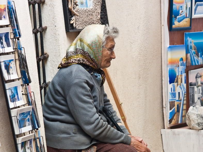

I have made some changes, and would like to hear comments. I moved detail down from the 70's to 50 and radius to 0.5
In PS: Unsharp mask- Should I have moved the radius down here too?
I'm a bit unsure about thr image "popping out" Radius 1.9 I know one should look at the 100% image, but find it very difficult.
Radius 2.6
Used this one- radius 3,6
Screenshot
Final product- could not upload from my computer directly- stated that I did not have the privileges, etc.
Thanks for any comments!!
Since you have Photoshop CS5, why don't you try the smart sharpen instead of unsharp mask? A lot less work and, IMO, great results.
As far as your latest edit, I would say somewhere between the two. Like I said, I would have just taken the Opacity down a bit on your last sharpening step from your first edit instead of redoing everything, but then again, I also don't use Unsharp Mask and will only occasionally use the High Pass filter method. For me, smart sharpening does a great job and I also have an action called Boutwell Magic Glasses that does an amazing job.
