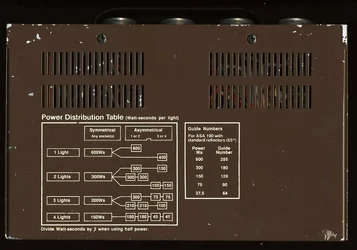

I think of an SB 800 or a 580 EX-II as being about 60 Watt-seconds of power at the maximum, and I think of an AB 800 as a 300 Watt-second flash, tops. (I am thinking of the Paul C. Buff light units based on Speedotron's "old standard" 11.5 inch 65 degree beam spread reflector, which at 300 Watt-seconds has a GN similar to the AD 800 with the Paul C. Buff 11-inch, larger reflector.
Alien Bees Guide Number? - Photo.net Lighting Equipment and Techniques Forum
