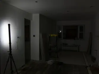

This is the finished product:
Here it is lighting up a completely dark room:
The far corner is ~ 20ft away and the lights not pointed at it.
To give you an idea. From two feet it measures two stops above ambient with a full charge. To put that into perspective... that's something like a GN of what, 4ft at ISO 100? I'm really not certain, but it's not a lot.
