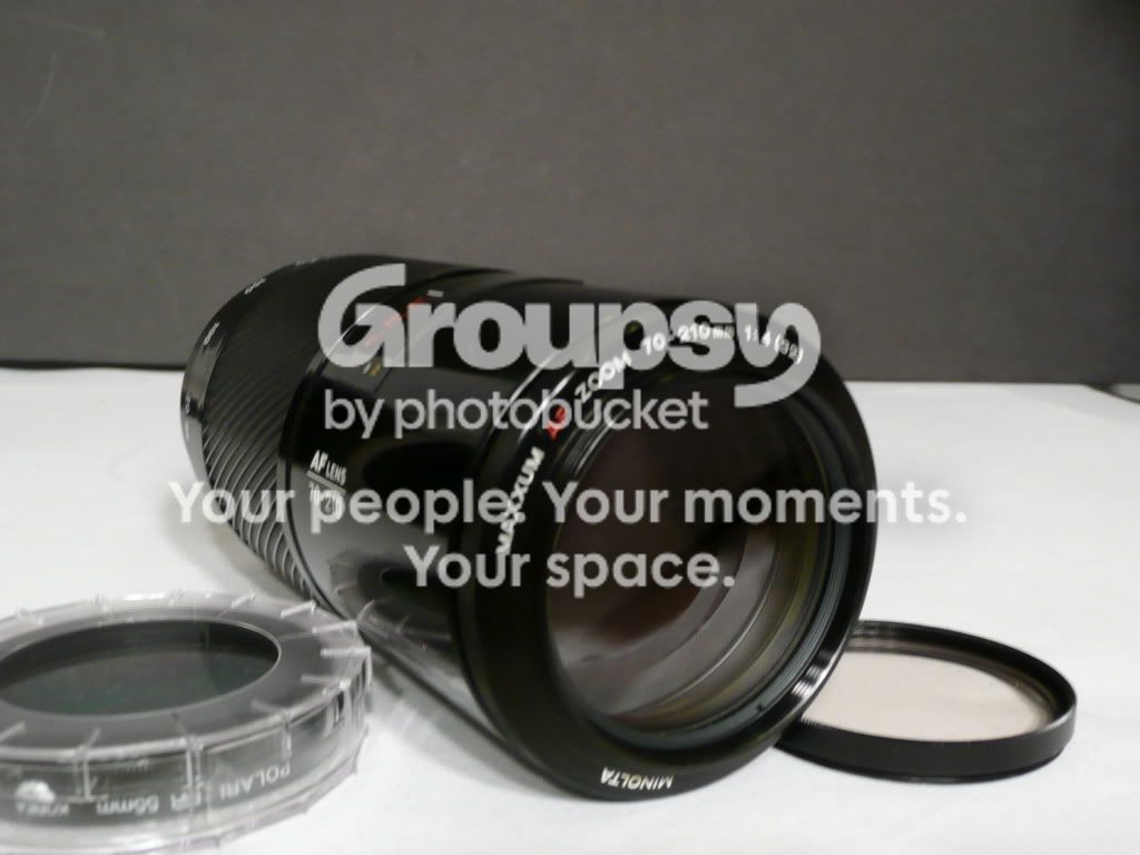

if its a Maxxum lens then it is an A-mount and will work on any modern sony dslr/slt. if it is a rokkor lens then it will not unless you get a rokker to a-mount adaptor. but even then they really dont work that well due to just being the wrong size to properly reach infinity. Sounds like you probably have some maxxum lenses. This should be marked on the lens some where but they are black and look like this for the most part....
A Minolta manual focus lens would not have the gold contacts ... only AF lenses have electronic contacts.
