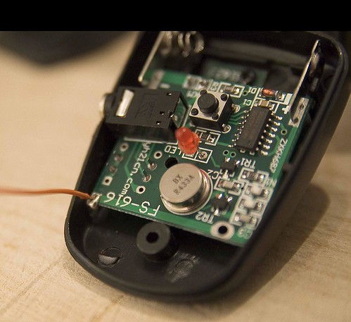

I received my Cactus V2s yesterday (ordered 5 receivers, 1 trigger... and while there, a remote wireless camera trigger for my Nikon D200). They took a little over 2 weeks to arrive. Not bad considering Hong Kong is on the other side if the world.

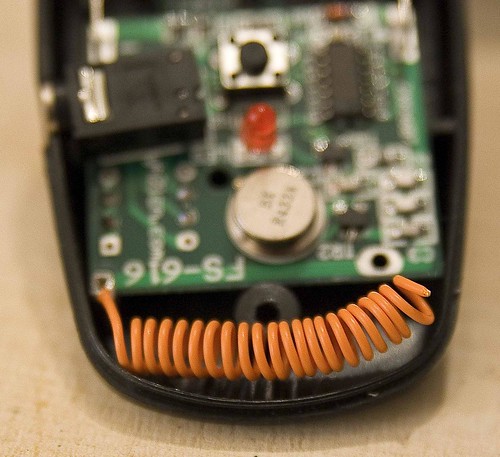

Anyways, using the original weak batteries, best I could do is 10 paces (~30 feet), before it stopped triggering the flash. Five easy minutes later and I went to 40 paces (~120 feet), before I had to stop or trespass on my neighbor's lawn without yet hiting the limit.
I saw all the different mod variations and read about all the good results people were getting, but I realistically said that if I could double the range, I was more than satisfied. Well I quadrupled the distance, and still had not hit the limits, so I am one happy camper!

For those wondering, I used a single strand of cat 5 network cabing wire (single solid copper strand), cut to exactly 12.39 inches (a full 1/2 wave antenna, I believe), to get the effects that I am acheiving.
