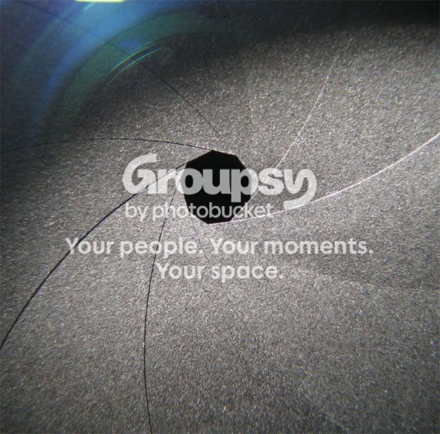

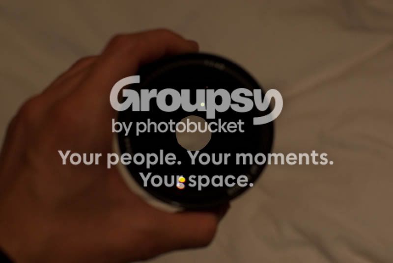

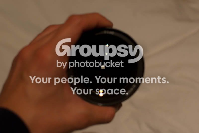

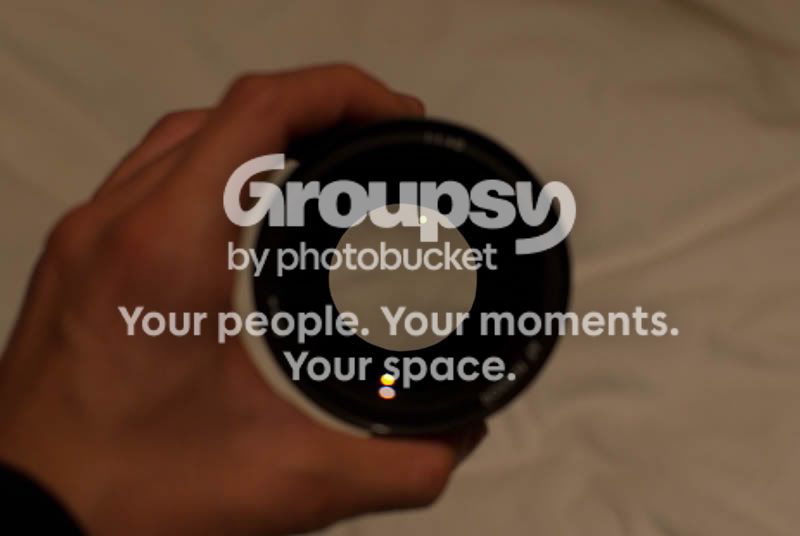

For your comparison:
Garbz, is that top one wide open? Shouldn't it be a perfect circle wide open?
OP, I'm pretty sure no lens is a perfect circle when stopped down. Even with rounded aperture blades, when you start stopping down, you would progressively start seeing the 9-sided polygonal shape. Or do you mean that it's oblong, as in, not an equal-sided nonagon?
The slight degree of out of round shape that Garbz's photo set is showing is reasonably common--many lenses are not perfectly round at their smaller apertures, especially at the f/16 and f/22 zone. One blade is quite often slightly out of alignment, as seen on Garbz's lens. At wider apertures like f/5.6 and wider, the out of round nature of a slightly mis-aligned diaphragm blade is pretty difficult to see in out of focus highlights.
No the top one is at f/2. You wanted to see the blades so I figured it would be pointless to show the f/1.4 :)

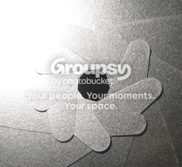

Mine is like his, but more unequal (as in not an equal side polygon). I dont expect it of course to form a perfect circle, I just meant merely that the blades are not even (quite oblong). Ill post some pictures of mine soon
edit:
Here are the pictures:
For some reason it looks worse in person than these pictures, but maybe its just my e yes
I wouldn't know better - I'm still pretty new - but it sounds like you're being super-critical and it's normal. Do the blades on your other lenses form perfect polygons?
On a side note, those are the coolest aperture blade macro shots I've seen. :P
That is definitely not an issue. Here's a little food for thought, bokeh is only rendered in the perfect shape of the aperture blades when they are a) stopped down, and b) the edge of the lens doesn't come into play.
If the lens produces good pictures at f/1.4 where only the very centre meets this criteria then you won't at all notice the slight variations of the aperture blades.
Yea, I decided to keep it, this thing takes AMAZING photos!
Btw, as for those shots, they were taken with my little canon SD600 point and shoot! Ijust set it to macro mode on manual and fired away, I love that little thing! Shows you dont need the best camera to take nice photos :-)
