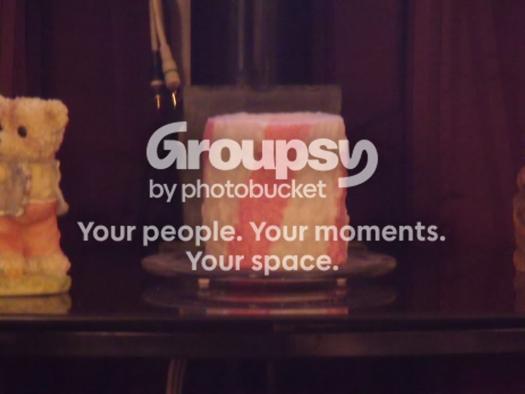

That was an attempt at a candle.
And this is with the settings you told me.

You really need to use a tripod or set the camera down on something...

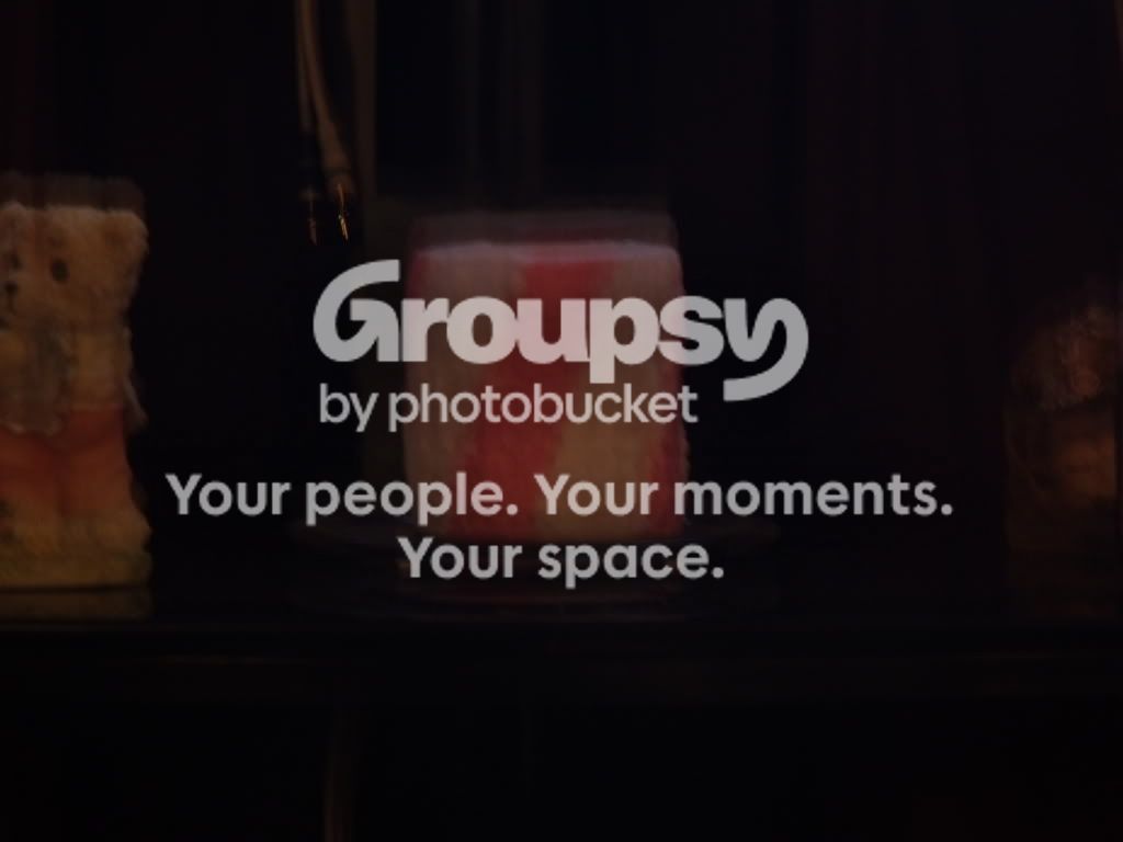

same settings with flash...
[in manual mode]

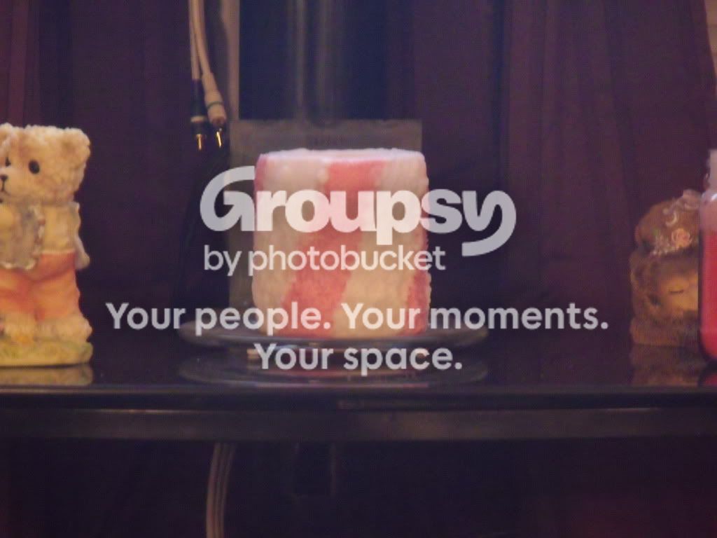

Manual mode with Auto Settings:
