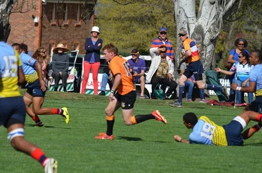

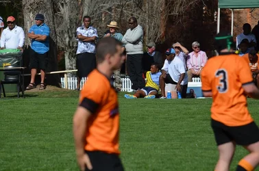

I really am an aged newbie, so need to be treated gently please. I have tried to get through some of the threads on the forum but just get lost among the details. I'm more a "post photo" person and use Photoshop quite extensively for cropping, rotating, sharpening, etc., but taking the original shot is driving me crazy.
I used to have an old Kodak EziShare Z740 so just had to point and click to get a "reasonable" picture. I now have family playing higher-level rugby union and like to take pictures for distribution on club websites, facebook accounts etc.
My problem is getting the foreground subject (Player) in focus instead of the trees or crowd in the background. I understand this is a Depth of Field problem (dof ????) but don't know how to fix it. I seem to get a percentage of the pictures with exactly this problem.
I've tried reading the manual, and following various threads, but just get lost. Basically I have the camera in Sports Mode, with Continuous Shots. Everything else is in "auto".
I've included two of the shots with the players quite "large" in the picture, but the camera has focussed on the background. I reduced the sizes to 1000 wide as suggested.

First of all, what camera and lens are you using? Generally speaking, there are two approaches to sports photography: One is to use single-servo AF (Nikon term, others have equivalent) and the centre focuing point, placing the focusing point on the subject and shooting. The other, (usually better) is to use continuous servo AF (ideally with back-button focus) and follow the action maintaining focus as you go. Read up on the focusing modes for your camera, and consider using shutter priority (1/500 sec min.).

Not exactly a depth of field problem.
With your old camera the focal length was relatively short and the depth of field at any lens opening (aperture) was greater.
So most things were in focus as long as the lens focused somewhere.
With the new camera, you are probably using a longer focal length lens (with a smaller depth of field) and you are not focusing on the player but the background. With a shorter lens it wouldn't matter but with the longer lens it does. So you need to learn to keep focus on the player.
Make the focusing point smaller, learn to pan with the player and use continuous focus.

Thanks TiredIron (sounds a bit like my golf stroke). I put all my camera details in my profile and thought they would just automatically pop up against my thread, sorry about that.
Camera Nikon D5100
Lens Nikon DX - AF-s Nikkor 55-300mm 1:4.5-5.6G ED
I have the lens set to A, and the VR to On.
I have been using Auto servo AF AF-A as the manual says AF-S is only for stationary objects. Also I have the Mode set to sport, so can't select anything but AF-A in Sports Mode. Unfortunately, I also can't do anything with shutter priority when set in Sports Mode (perhaps I shouldn't be using Sports Mode at all ???????)
I'm using Dynamic Area AF as the manual suggests this for moving objects.

I am going to try single-point focus as I have the players in the middle of the Focussing Area but for some reason (in some photos) the camera decides it likes the background better???

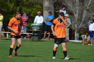

I am panning across the action as best I can, but I must need more practice. This is another picture from the game and it appears to have ignored focussing on the background - perhaps this means I am not panning correctly, as the players are moving a bit slower???
Keep in mind that the camera will attempt to figure out what is the actual subject your are shooting. In some cases, it will recognize the players in the foreground and focus on them. Other time it thinks you're trying to get at the guys on the side line.
Using a single focus point aimed at a player like TiredIron suggested will limit how many objects are potential target and it should focus more reliably.
I'm not familiar with de D5100, but usually in continuous AF the camera will anticipate the direction and speed of the subjects movement in order to keep it in focus when the shutter opens a fraction of a second after you've actually pushed the button. So if you are zoomed in really close and the player changes direction at the bad time, you might still miss him a bit. Be aware of that when figuring out what setting to adjust. You might have had it perfectly setup.
Did you ever consider back-button focusing? Not entirely sure how to set it (or if it's possible on a Nikon). It allows you to essentially pick the subject and fire as many shots as necessary provided the subject distance from the lens doesn't change. With a pretty significant DoF, you should be able to click away. I use it when my girls are on swing sets, constantly changing. I can adjust it to wear it's focused at a distance, not necessarily on a subject and click when they're in focus, not when the camera tells me they are (i.e. Canon EF 50mm 1.8 is REALLY slow, but DoF is great). It allows me to choose the sharpness of the picture and not allowing the camera to do it. IMO, I prefer back-button focusing because it keeps ME in control, not the lens or the camera.
