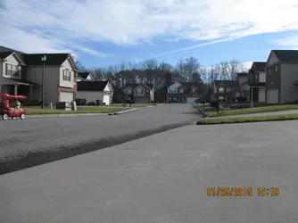

I can show the real focused image through the same acrylic glass that has the same clarity as IMG_0380.JPG.
The focusing distance is about 150 mm.
The focusing distance for IMG_0380.JPG is about 1000mm.
The clarities and sharpness of both pictures are the same. May be illumination is different because of times.
The Focuses are different! So the problem not in quality of glass. I think I have a good logic.

To me I see a massive difference in quality. give me a few to show some crops
There is another one with the glass that has a similar illumination
the original 038 shows details in the windows, the cross members and such. The other ones, including the one you just uploaded, with the acryliv have lost ALL detail.
It's even worse if you look at the house to the left. I thought they put a sheet of plastic over the house in one of the photos - zoom in and look at the windows.

At first I thought the one picture with the acrylic that you just uploaded, the owners put plastic over the windows to keep drafts out. But when I checked the houses to the right it was the same problem.
But on the #62 image if you just look at the windows it looses all detail. Even the shutters are nearly gone in the image of the small window. The windows look like it has plastic over them.
The bricks has lost all detail. The roof. If you see the full image the trees are all fuzzy.
You may not be used to looking at photographs and comparing but once you do, you'll know the differences. this is all due to the "acrylic" not being "optical quality".

The post became little bit confusing. The last two pictures that you compare made in a different times of the day (that is my fault). Originally I supposed to show focusing issue. Just compare IMG_0380.JPG and IMG_0176.JPG that I attached that is still made in a different time-shades distribution.
Ok, forget about it.
but we're not talking about the light / time of day.
we're talking about the fuzziness of the image, or "washed" out image due to the acrylic.
The window detailed are totally different. bricks are washed out, and roof, trees .. not due to lighting variances.
Thanks for discussions. I'll continue this thread with more strict pictures/questions if I get one.
After all I figured out that infinite auto focusing gives a bad result and average distance focusing setting gives sharp image through the same acrylic glass. In this way I could resolve my problem without understanding why it happens. There is no real physical reason for it. I would assume that the glass somehow affects focusing mechanism or algorithm when focusing is setup for infinity. This is my big project and I cannot avoid using acrylic screen because it's a waterproof case for my camera.
