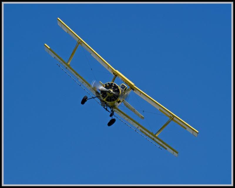

Here are couple with shutter setting of 500 and 1000 respectively ...
500
1000
To maintain the prop blur, you want to keep the shutter speed to 1000 or below and pan. 1000 is getting very close to stopping the prop, while 500 or even better 320, will give a nice blur. Looking for a specific power setting on the plane will make no difference as these planes all have constant speed props ... which means the propeller rotates at a constant RPM regarless of the engines actual power setting.
