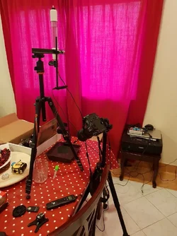

A picture of the set up used in these photos, presets from the stop shot set is the default settings for two drops (if it aint broke and all that). Only thing missing is the reflectice backgrounds used to cast colour on to the images

Thanks, these are good fun to take, simpler set up can be created with a cardboard box and a medcine dropper
