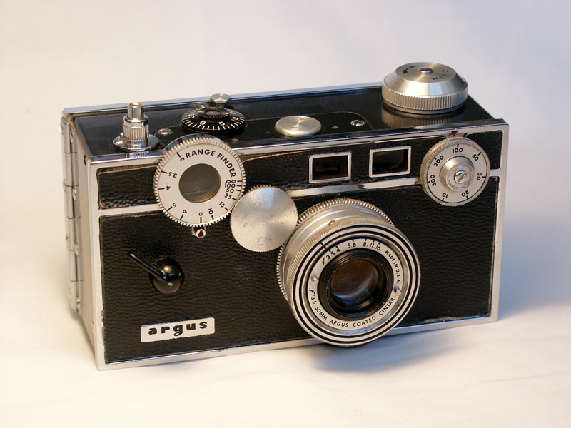

I think the answer is that the iPhone's designers were trying to avoid THIS form factor...with its 50mm f/3.5 lens...

Isn't that a modded shutter button, for a cable release on the Argus? Always wondered why digital cameras didn't have a cable release thread in the shutter button. No really, I did at first. Still wonder on the P&S that don't have an option for some electronic button. But since pretty much all of them have a 2 second or 10 second delay I guess it works.
