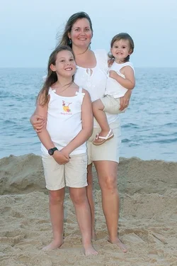

Beach photo.
If you don't have time to set up OCF, I might at least handhold the flash to the right or left, and take the picture with the other hand. Or just go easy and buy a flash bracket.
Also a CPL filter may have helped with the color.
It seems like it was processed in Lightroom with the default Adobe profile. It has a very unnatural contrast and weak colors, ruining in other ways good photo.
Somebody forgot to take notice of the "winky face icon" in an earlier post.
I pulled a large version of the file into Lightroom...hmmm...f/5.6 at 1/160 second at ISO 1,000. The image has plenty of noise, and the lighting is on-camera flash fill, which lead to a pretty flat lighting pattern. The sky and sea, lacking the drama of an approaching high-country mountain summer rainstorm, are both pretty monochromatic. I looked at a few things...I modified the Blue's luminosity and saturation a tiny bit, but didn't want to make it look obviously faked.
The problem I saw in adjusting the file was that the whites seems overly-bright for the water and sand, and the degree of flash is very high, so the light has very little modeling on the faces...the catchlight is smack-dab in the middle of the eyeballs.

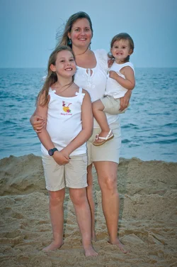

.webp
I modified it to make it look like an end-of-the-day kind of shot...I thought the original file I pulled off the Flickr page looked too bright.
I tried to tone down the shadows cast on the beach, with limited success, and painted on a little bit of modeling shadow as if from some light source camera left (which seemed to be where the actual ambient might have been coming from):
My main critic would be the direct straight front flash, IMO it makes the image flat and there's a lack of shadows. Color tones can be corrected later on with a software.
A little flat. I am having the same problem. You captured wonderful emotion:)

I did this one for your pretty family.
That's just painful to look at right there.
I appreciate trying to warm them, but
Thanks for the edit. I think this actually looks pretty damn good, considering what you had to start with. I realize OCF is best but under the circumstances I just didn't have the right equipment or the time to set it up.
