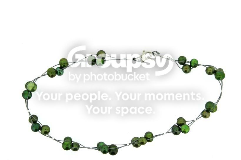

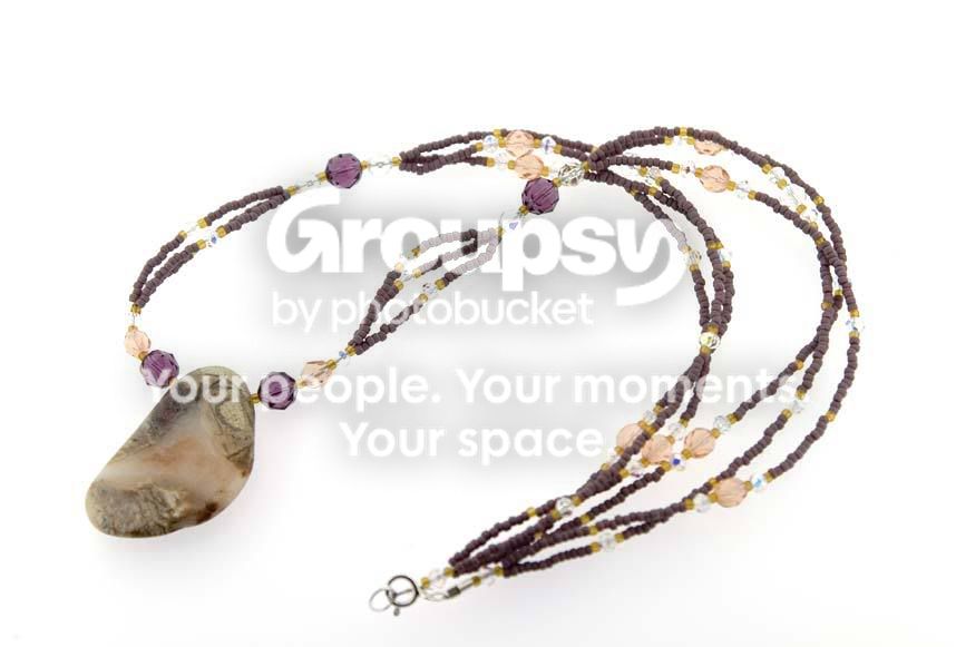

I have a few questions Im hoping I can get answered. I am shooting items such as small crystals, and jewelry. They are in various shapes, sizes, colors. I am using a Metalight light box as well as a Cannon 10D with a Cannon 50mm Compact macro lens.
No matter what I do I get a green tint when I take photos in the light box.
What is causing this? Im not very good with anything other then a point and shoot camera. So Im not sure of the settings I am using, or what they should be. Any help would be great.

Well that's the problem. Auto white balance doesn't work very well, and fluorescent lights give off the worst colour casts I have seen. For whatever reason they always come up green.
Anyway you have a few options. Either play with the white balance (5000k is daylight so that's a good place to start), or shoot in RAW which allows you to select a white balance in post processing software like camera RAW.
Well I am shooting in Raw now, I tried a manual white balance and it did improve a bit. Im going to post a few examples of the items I am working with here shortly.
