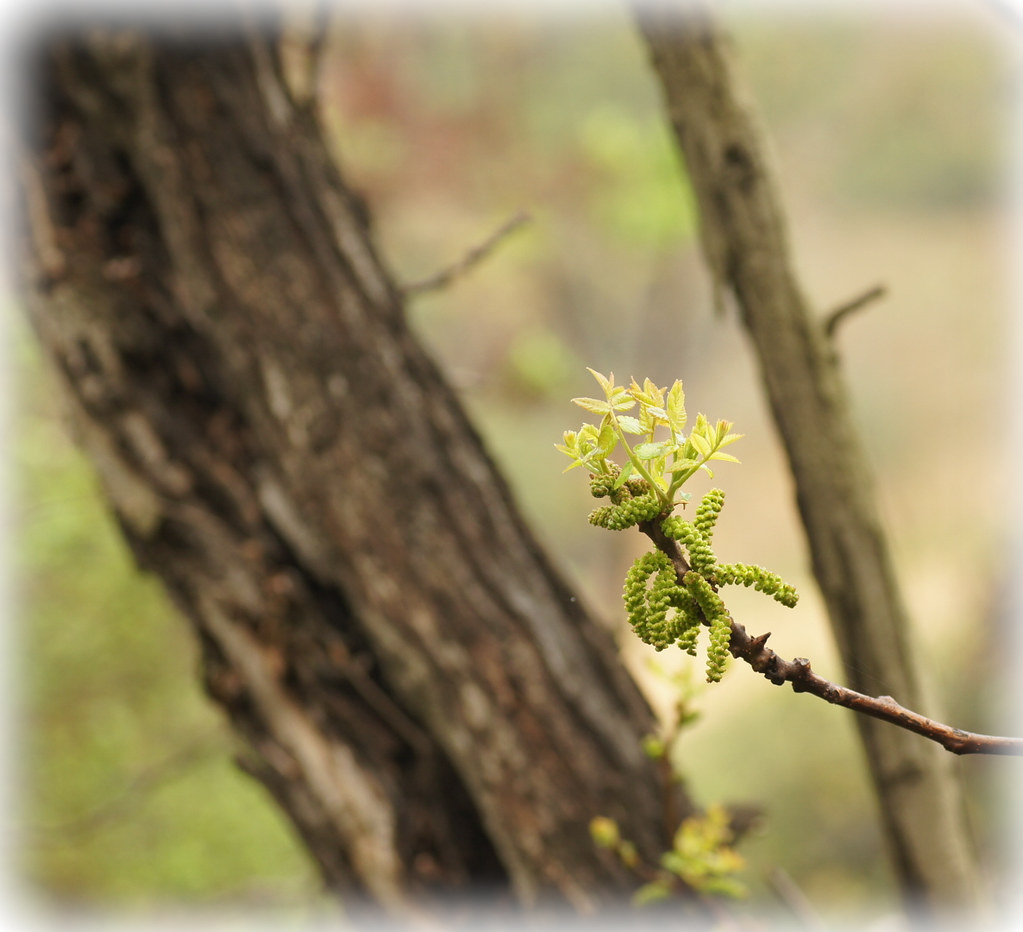

It may have been this photo that you saw, I might have posted it in a prime lens thread because I am huge fan of prime lenses.
I shot this at f/3.5, but I did so with an 85mm focal length on a full frame camera, which gives me more reduced DoF than on an APS-C camera w/ the same settings, focal length, and subject framing.
The longer your focal length, the shorter the DoF at f/3.5... So for example, if you're shooting at 18mm @ f/3.5 your DoF is going to be 1.48 meters. If you're shooting at 85mm @ f/3.5 your DoF will be .05 meters.
As you can see, there's a drastic difference that focal length will make at a constant aperture. So the least DoF you can get with your current setup is 55mm on your kit lens at f/5.6 which would be .15 meters (without knowing the close focus distance of the lens).
Just make sure the background is far from the subject (and you are close) and it should be doable.

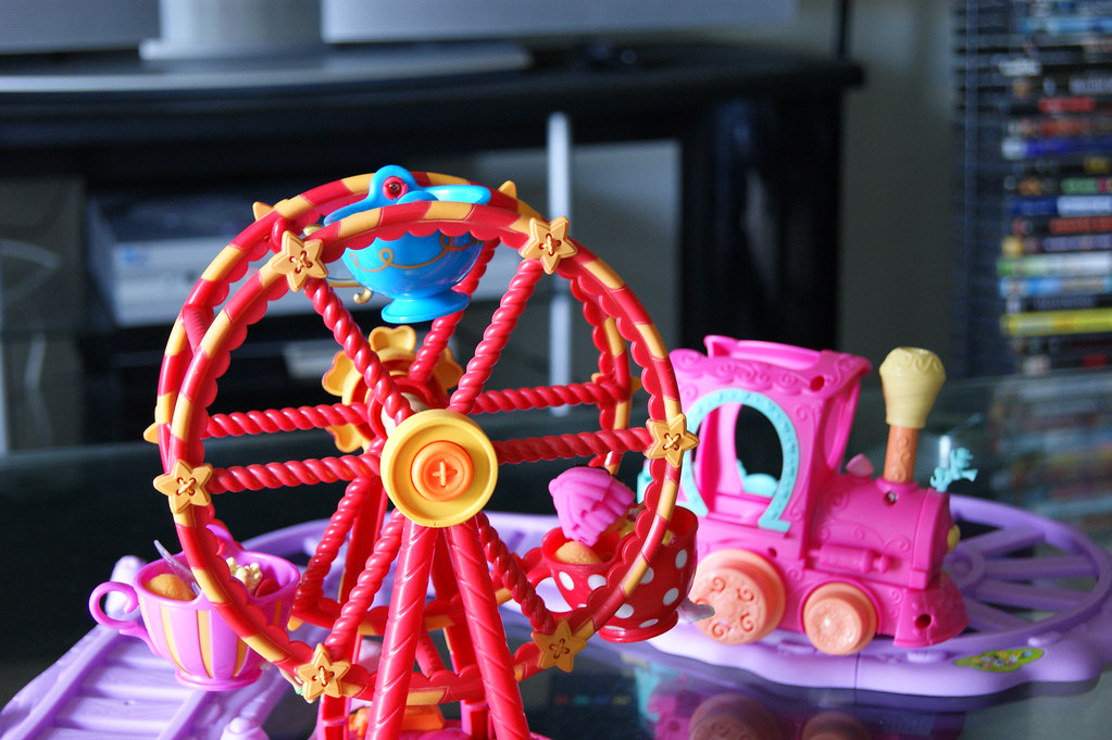

thanks you all for your help with this.. Mach0 and o hey tyler thanks for the technical aspect. It helped me learn and understand DOF in relation to the subject and lens. http://www.thephotoforum.com/forum/members/22540.htmlO|||||||O thanks for the layman's terms. Sometimes I need to hear the "for dummies" version to understand the technical. in all I took this picture which i think put what all you said into perspective. I wasn't worried about composition or didn't even do any post production. That's a whole other war going on in my head. Just trying to do it one technique at a time and actually have fun taking pictures. Well here the pic I took which had the effect I wanted and didn't even need to get another lens to do it..
thanks guys
That looks pretty good. Just get a farther background and stick a human face in the middle [or wherever fits compositionally] and you're golden. :)
